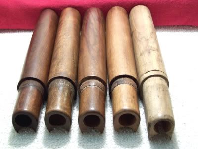

...and, so you can see what can be done with an old beater, I will add this:
My '94 came with a short frontend (seen here after I refurbished the rifle):
I bought a bag of "unknown" (probably for some Uberti rifles) long forends off of eBay, from a guy in France:
I sold all of them, but one. I adjusted it to fit my '94, and I bought a secondhand sling from a pawnshop (for $5.00) & added them both to my gun. Here she is, today:
I think that the long wood really makes the rifle. The sling actually appears, to me, to make it look like a working gun. Good luck, Bruce! :wink:
Shawn
