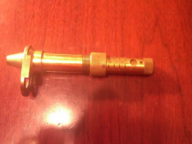

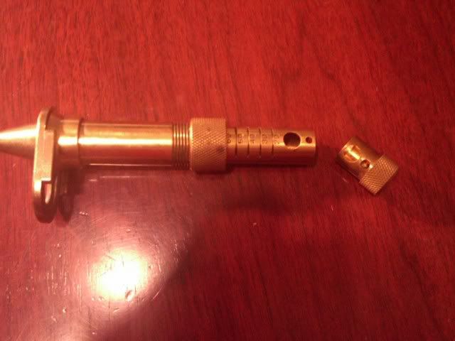

I have an old adjustable blackpowder measure. This is the kind that is roughly tube-shaped, with a cone at the top. Adjustable from 20 - 120 grains. All brass, unlike the mostly plastic ones sold today. The bottom had a piece you could turn to open to store percussion caps. Handy little item. It is retained by a small ball bearing and spring.
Oh, about 25 years ago I managed to launch the ball bearing and spring into low orbit. Dug the unit out of storage last week, cleaned it up, and I would like to replace the missing parts to get it working again (I can still use the measure itself). Figured i could use some shot, if I can't find a ball bearing small enough. I need a little spring - a really little spring. Overall diameter needs to be small; I can cut it to length if need be.
Got any ideas? I'll try to take a snap shot of it, but won't get a chance this week.

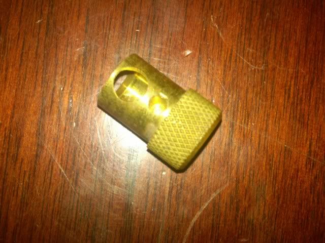

Thanks guys! I was traveling all week, so couldn't take any measurements (left Monday, got back today, and worked in all four time zones in the continental USA this week!). Sorry for the miserable pictures from my cellphone. The hole is 1/8ths inch in diameter, and 5/8ths inch deep. The ball bearing can not be smaller than 3/32ths of an inch or it would pass through the detent hole. I'll check out McMasters.
Steve - Y2K thought of a pen spring as well, but I haven't found one small enough.
M.M. Wright - thank you for your offer!

I have ball bearings .123 and .124. Springs: .112D X .400L, fairly stiff, .115D X .500L, soft, .096D X 1.8L, fairly stiff, .111D X .165L, fairly stiff and .104D X .160L, fairly stiff. If you want any or all of that, let me know, its yours.
