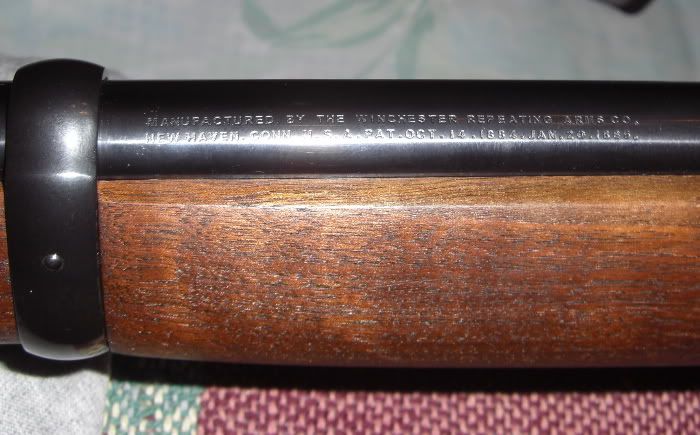

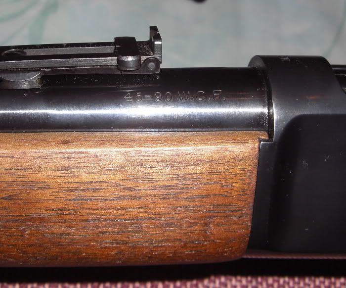

Okay, if this works...here goes..this is a picture of a 1906 winny with Pilkingtons English Red (appears to be the same as Tapaderas N35Red).
And here is an 1892 winny with the same stain and finish. For some people this is too red, but remember you can mix it with a spirit based brown (ie: N35B if from tapaderas) to cut the red some.
