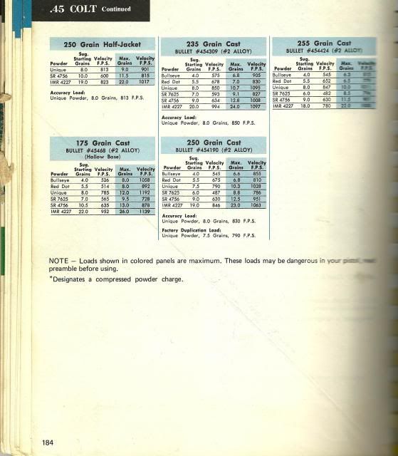

Admittedly, this is in a pistol cartridge, but... look at .45 Colt max loads, (from that same 1970 Lyman manual). It lists a max load for a 250 grain jacketed with Unique as 9.0 grains for 901fps... yet lists a max load for a cast in the same weight as 10.3 at 1028fps.
That lil' bit of data extrapolates into that, in fact, lubed lead bullets can be pushed harder than their jacketed counterpart without excessive pressure. What effect a gas-check has vs. a full jacket, I've never investigated. Maybe my logic is faulty, but... I don't hotrod anything... I've seldom pushed the envelope on recommended loads... although newer manuals and web sources don't go to my 27.5 grains of RE-7 for a 150 grain pill in the .30-30. My 1980 Speer manual #10 lists 29 as max.
I get nice flat primers, but no indications that they're "flowing", just nicely flat. If you want, I'll post up on the board and open up for comments... might be interesting to see what others think.
The answer to that last was "yes", so there it 'tis. What say the experts on this?
