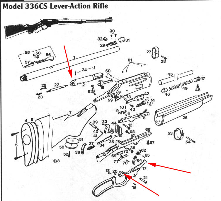

What a coincidence that you would post this since I just "smoothed up" my new 336 this past weekend. I used 1000 grit sandpaper and polished the end of the lever that goes into the bolt, the part of the lever that locks into the locking lug, and I polished out and smoothed the channel that the ejector rides in on the bolt. Made a big difference. The action is vastly smoother now.
To test the effectiveness of what I intended to do I tried a little experiment before I began polishing: I propped the rifle butt down on my leg, barrel pointing straight up and holding it only with my right hand I tried to cycle the action with that hand. I couldn't. When I tried to work the lever, rather than unlocking the action I would just lift the rifle off my leg. After the polish job I can easily cycle the action and the gun stays planted on my leg.
