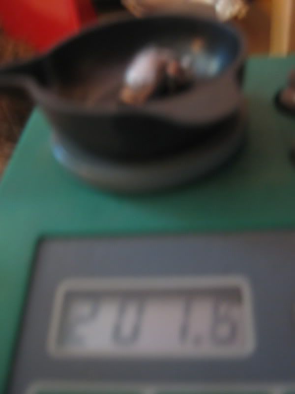

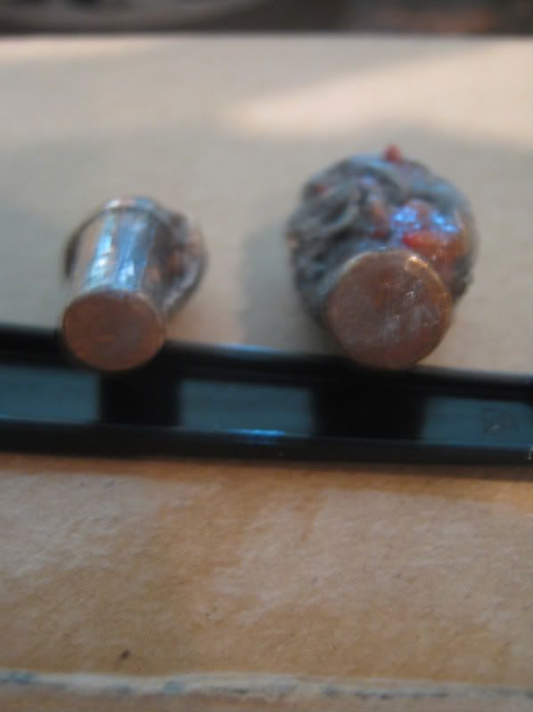

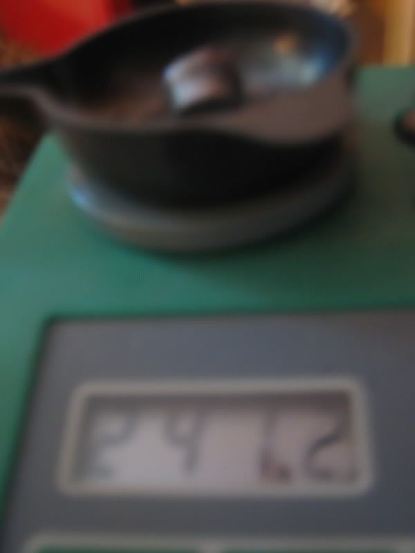

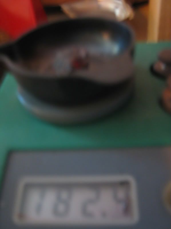

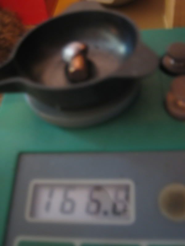

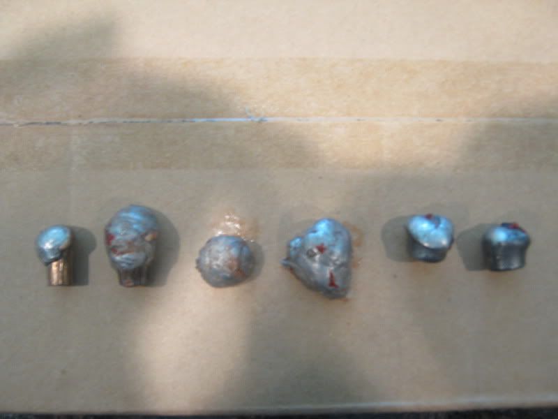

Since my last post in the past few hours I found out Jack's Dad had two hogs that were not fit for market. They were both domestic sows around 300 pounds. Already dead. I backed off 50 paces and fired away with the guns/loads I have been working with as close range medium duty rigs. We propped up the sows on their bellies and put them side by side. I rough measurement across the girth is around 22 inches. The rounds were 30-30 170gr Speer FP at listed mv of 2270 fps, 35 Rem 200 gr Rem CL at 2035 fps list, 300 Savage 180 gr factory loaded Win Silvertip, 308 Win with 170 gr Rem CL made for 30-30 at 2550 fps and two .451 diameter 240 gr lead bullets sabotted and fired from a 50 cal mzlder at 1850 fps mv (100 gr 777). Most interesting is that nearly all the bullet retained their total weight. The penetration was as follows, unscientifically measured: 30-30 19"; 35 Rem 22"; 300 Sav 16"; 308 Win 11"; 50 mzldr (2 shots) 15" and 18". The bullet weight may be a little high because I didn't clean any blood or meat out of them before weighing.
Here's the 30-30 170 gr Speer and the 35 Rem 200 grain Core-Lokt side by side for comparison:
Here's another view of the other side of the bullets all next to one another:
30-30 bullet
35 Rem bullet
50 Cal Muzzleloader bullet
300 Savage 180 gr Silvertip

Stretch,
I'd just about come to that conclusion after I'd looked at the pictures 86er had posted. Especially the one that showed the bases of the bullets. Until then I was having difficulty visualizing the difference between a 30 cal and a 35 cal bullet.
