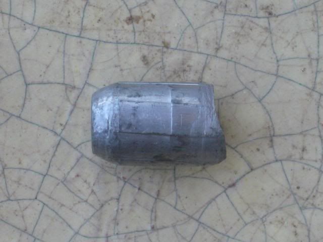

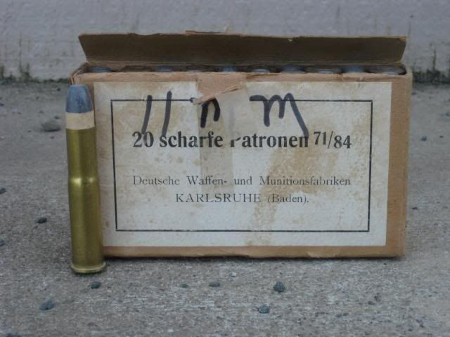

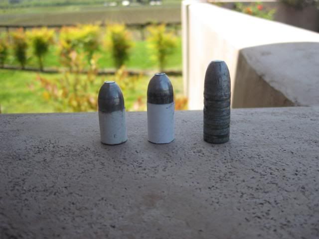

Here's a pic of the PP bullets I have been given to try in 373 and 430 grain weights next to the 500 grain cast bullet I was using to good effect at 1538 yards but is no longer available from Buff Arms Co.
The 445 groove diameter slug:
and my original box of 71/84 ammo:
-Tutt

Guys the 11.15 x 60 Mauser PP Military cartridge is set up to shoot an as patched, BORE diameter projectile...Multiplying 1mm or .03937” x 11.15mm converts 11.15 mm to inches = .4389755” in other words .439”which was the nominal bore diameter, so Tutt your antique patched rounds haven’t shrunk much.. Paper Patch Cartridges were also known as Upsettage rounds.. Ideally the patched bullet fit the bore with a slip fit or slight interference fit so as to have the proj centered in the lands with no slop, but not enough friction to ruin the patch.. Upon firing the round the BP thumped the proj into the grooves ..
Hey Ray.. In case you don't know this, each ! Mod 71 has its' bore diameter (as measured in the factory at the time of mfg) stamped in mm on the knox form, left side, just next to the receiver.. My 71s are both OESTERR.WAFFB.GES mfg’d. in 1873 & 1874 respectively, and read :11 & 11.1 respectively..11mm is dead nuts .433”, 11.1 = .437”

Ben, thanks for the clarification. I measured my slug again and while the groove diameter is .445 the land diameter seems to be .433-.434 at most after taking many measurements. I seem to remember reading that their were slight differences in the bores in some way between the original 71's and the 71/84's but I forget and would have to dig it up. I'm going to gently knock one of these .445 PP bullets through the bore later and see what happens. The exteriour of my rifle says 11 only and if you use your formula of .03937 x 11 =s .43307, then the land measurment would be about right. Very interesting, thank you!
