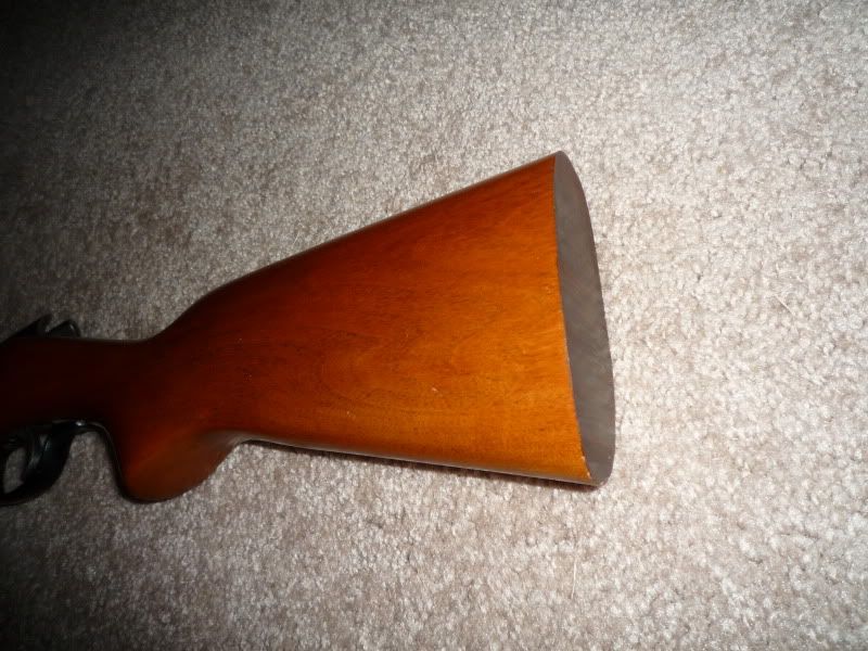

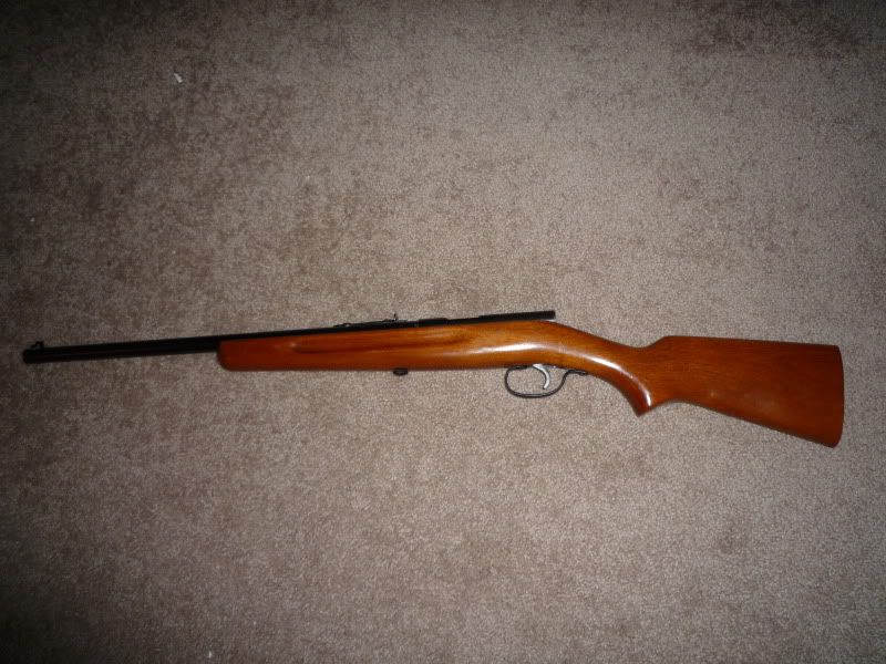

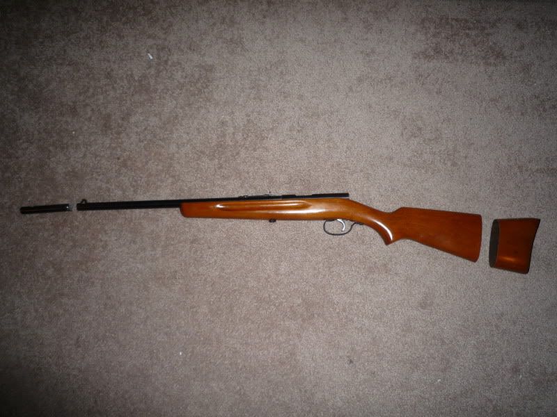

... sort of kind of. Actually it was a saw and a file. I was given an old Springfield Savage single shot .22 rifle. One of my boys likes the Cricket he has but the other wanted a "wood gun". I cut the stock to 10 1/2" and cut the barrel to 16.25". I then re-crowned the barrel with a brass bit and lapping compound. A dovetail was made with a square file and a triangle file and the original front sight was re-installed. The gun weighs 4 pounds and still groups little clusters, especially at 15 yds where we sighted it in at. It fits my boys just great!

How did you arrive at the 10.5 inch figure?
Re: OT: Took an axe to a rifle ...
Well done. You going to checker the "butt plate"?

We're going to groove the butt plate for now. I had my son hold the rifle and put his cheek on the comb. I measured 2 finger widths from the tip of the comb to his nose. This gave me 10 1/2". The OAL is within legal parameters. He can now shoulder the rifle properly and see the sights. This gun has a hand detachable screw on the rear sight. It comes off in a snap. We took it off and shot hand-thrown soda cans with .22 shotshells. Then we put it back on and shot squirrel targets with .22 shorts. So far, so good!

First, great job cutting down the rifle, looks great.
Wanted to mention, if you aren't going to butt plate it, lightly round off the edges around the end of the stock. The plate protects the corner of the wood to keep it from splintering if it gets dropped, etc.
Lightly rounding the edges gets rid of the sharp corner that contributes to the splintering if the end of the stock gets bumped on a hard surface (especially at an angle).

Be sure to save that piece of the stock you cut off. you can put it back on when he gets older. Of course the same can't be said for the barrel. :lol:
