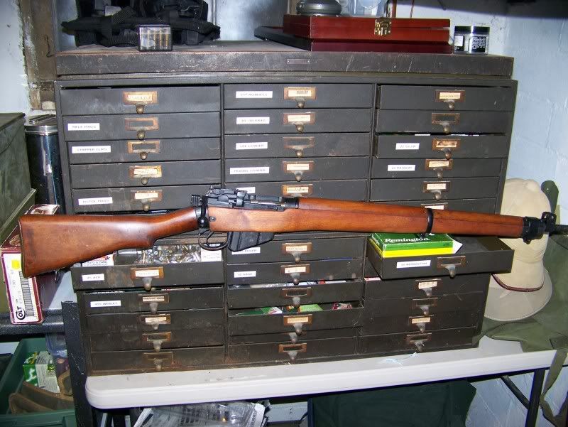

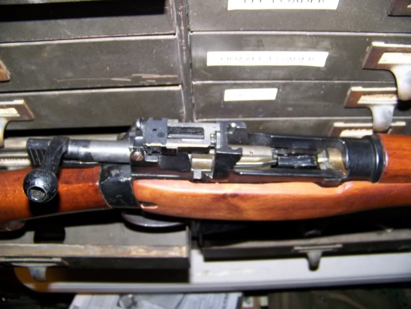

Here's one for ya!
Will shoot 1" @ 100 yds.
One of 2500 contracted for the Royal Aus. Air Force.
