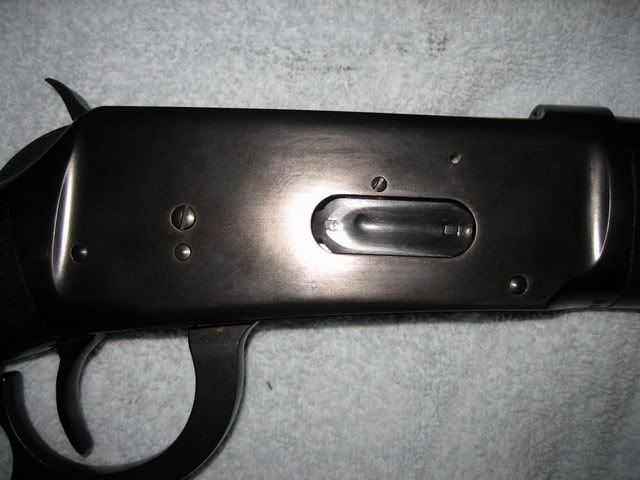

TCB, here is a link to my carbine conversion in "The one sticky"
Instead of trying to make cold blue look like hot blue on a 1980 receiver, I figured I would try to make the receiver look old.
I ended up using two coats of Birchwood Casey Super Blue liquid and 0000 wool between coats and it's holding up fine. Kinda looks like faded CCH.
http://onesticky.levergunscommunity.org ... rsion.html
I also refinished a 1965 Model 94 with the same Birchwood Casey Super Blue and it turned out pretty good!

Salvo, that's some nice looking wood on that first rifle! Both are nice guns, but that wood on the first one makes me drool.
Re: Advice on Winny 94 30-30 hack, reblue, redo, something......
Beautiful job! +1 focus on making it look older, although the other (dark "blue") example looks great too.
