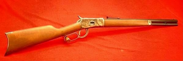

Re: Cutting a barrel
Post by Nate Kiowa Jones »
Warhawk wrote:I have one of the "Buds $365 Specials" myself, haven't had it to the range yet but the only thing that I know I want to do is swap the butt stock for one from a saddle ring carbine.
If you want a short Rossi 44, you ought to buy a Rossi trapper. I have one of these too, worked over by Steve Young. It is a fantastic little rifle.
But if you are set on shortening the 20" short rifle, search Steve Young's posts. He talks about shortening the fore end on one of these guns.
This is it. A 20" oct with the fore wood set back about 2.5".
I think it looks much more proportional compared to the stock 20" oct.
Here's a 20" cut to 16" from the breech end.
If you plan to leave the mag tube protruding past the muzzle you will need to figure out another way to fasten it so it doesn't slip under recoil. Tha't's because the plug screw helps hold it by seating into the bottom of the barrel now.
205 Antler lane
Lampasas, Texas 76550
http://www.stevesgunz.com
Email; steve@stevesgunz.com
Tel: 512-564-1015

Thanks for allowing me to bounce the idea off ya'll. It appears that the short rifle special comes in at 1.6 lbs over the carbine and it doesn't feel right, to me.
I like the 20" brl, 10 rnd tube capaciity, weight and balance on the carbine so I'm not wishing to create a trapper model, yet I've already bought this short rifle and need to do something, somewhere down the road.
The 2.5" off the foresrock looks a lot better and thanks for posting the pics.
I guess cutting from the breech end is prefered coz you maintain the crown, blue and relationship to the mag tube.
I'm only guesstamating in my mind and that can be dangerous coz there's a lot of room to wander in there.
I think 2-2.5" of the buttstock(youth carbine?) and 2.5-3" off the brl would put me closer. I had measured and determined that I could cut no more than 5" on the forestock. I would probably save that 2.5"-5" for the last cut.

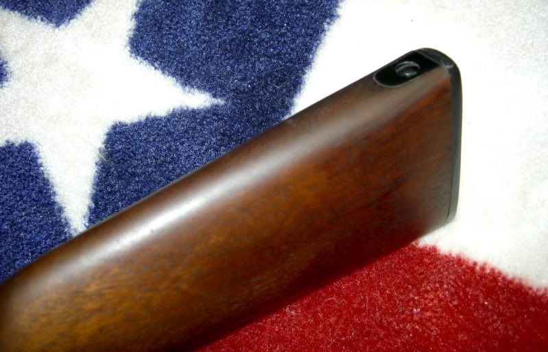

I saw that plug screw and had wondered about it and its function.
Steve, you had shown a pic of a flat burrstock pad as being more practical. I was curious that if the rifle brl was level would this flat, straight pad be on a 90 degree angle in relation to the brl?
Just eyeballing the curved buttpad it looks like the angle would be less than 90 degrees.
Could be an optical illusion on my part.
You cut the brl 4" and only cut the forestock 2.5".
So, you cut another dove tail and if you'd cut 4" off the stock you could've used the same dove tail to affix the stock from the breech cut brl?

Nate Kiowa Jones
Site Sponsor
Posts: 2508
Location: Lampasas, Texas
Nixterdemus wrote:Thanks for allowing me to bounce the idea off ya'll. It appears that the short rifle special comes in at 1.6 lbs over the carbine and it doesn't feel right, to me.
As it is the crescent butplate is about 90 degrees more or less but you can cut it whatever you want. I prefer a slightly negative toe on hard recoilers. It doesn't dig into the shoulder chest as much. See pic below.
The 20" stainless gun only got the forend cut 2.5".
The Blue and color-case 16" oct started as a 20" and both the barrel and the forewood were cut 4" from the breech. So, yes the dovetail for the forend tennon was reused on this gun
If I wanted an 18" oct Rossi with a shotgun style butt I would start with a 24" oct, cut the muzzle to 18", (This will eliminate the twist-in mag hanger) re-hang the mag tube with a Marlin style hanger and cut and redovetail the fore wood back about 3". For the butstock I would use a Carbine stock as is or cut it and add a plate or pad. When cut to shotgun style the crescent rifles stock doesn't look right to me.
