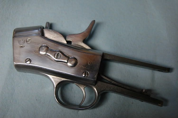

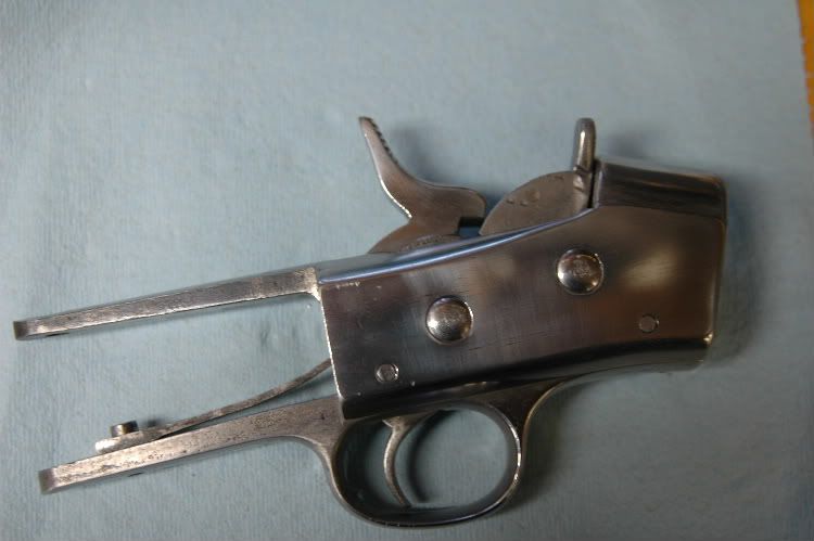

This little guy started life as a 7X57 rifle, built by Remington, doubtless for some low budget military somewhere. What you see is how it came to me.
It's in good order, so it's begging for a build.

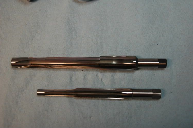

Building it for a friend. I donated a wall hanger I had for 25 years. Egyptian .43 cal that was in pretty rough shape. Of course I get to do the metal work. So far I,ve lapped all the frame holes and breech block and hammer to the same size. Fit new pins. Bushed the breech block and turned the firing pin to .080. My barrel is ordered. it will be a 50-90 Sharps when finished 1+1/8 Full octagon at least 30 inches long. Wood has arrived from Trebone My buddy gets to tackel that part. See attached pics Manson 50-90 reamer along side a 308 reamer for size comparison.

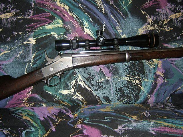

I've got just about every flavor and age roller..All the ones I've shot have turned in near 1 hole groups and some actual 1 hole groups..Always 5 shots@100yds. I temporarily scope them for ammo development and never look back after I got 'er figgerd...This pick demonstrates what I'm talking about... Don't forget to do the math and subtract for bullet diameter...
No set triggers ..just backed off the trigger screw.. Bone stock stock rifle.. the muzzle diameter of this sucker only measures .709" .. Lets see...709" minus.512" leaves .0985" of meat around the grooves!! ..Always a nice lube star on the muzzle of the whippy 36" tube.. I'm amazed that there is after snaking a bullet for 36"!
WLR primer, Thrown charge 54gr IMR 4350, Single dipped room temperature Lee liquid Alox lube, Unsized Lee .515/450 bullet, WW alloy BHN 11, all bullets weighed between 426.0 to 426.9 unlubed, Quarter sheet TP lightly wadded into a ball contacting the powder with the bullet base firmly seated on it. The bullet engraves when the block closes..
Final Chrony 10 shot string result
Lo 1274
Hi 1319
Av 1298.3
Es 25
Sd 12.2
Gun:Remington Rolling Block
Circa 1873 50-70 New York State Militia Rifle
Barrel 36" long
5 lands and grooves equal width approx .512"deep
Twist 1/42"
Wt. 8lbs 12 oz
Starline 50-90 cases annealed and cut to 1.9" instead of the standard 1.75" that 50-70s cases are, so as to allow for Remington's long throating..
Lots of stuff out there about the good old roller...But here's the point Remington made about their military smokeless rifles...The Roller did not suffer from having to be replenished every 5 rounds with stripper clips, or use two to charge the SMLE..Therefore overall rate of fire was at least as fast as the bolt action. However, when expense, manufacture time ,and time to load the stripper clip before shipment were considered, the roller was faster and cheaper in use than the bolt action rifle! I've seen WWI German combat footage and Russian WWII footage where the soldiers are standing at a berm with their rifles lying on it not aiming and cranking out rounds using the left hand to operate the bolt and the right hand to pull the trigger.. This was not an uncommon technique. The roller could be aimed every shot.. The bolt action was only faster for the three or four magazines.
