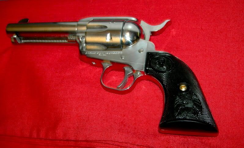

Old model Ruger Vaquero - built like a tank. accurate. fun, I like em!
negative: not a true clone, a bit heavier than I prefer.
I had a matched pair for cowboy shoooting for 7 years.
Never a single problem with them.
Ruger Blackhawks - same positives as the Vaquero.
Has adjustable sights.
negative: factory grip too short for me. Weight.
New Model Ruger Vaquero: Handles better than the original.
Only negeative is it is not a true SAA clone.

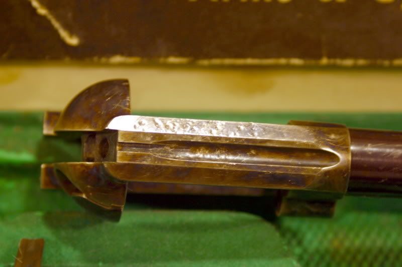

After he brought it back I took a few pictures of what I had left. Not much but here they are:
If you look at the upper left corner of the box that’s where the phonetic obscenities were written, they were scratched out before I got it.

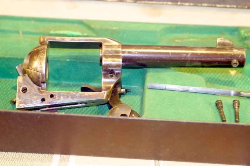

Here’s an overall view of the frame and barrel. Pretty scarred up.

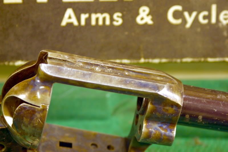

Top and right side. You can clearly see the pock marks from the .22 bullets.
Top view. Why the frame did not crack or fracture is one on me. Glad it didn’t though.

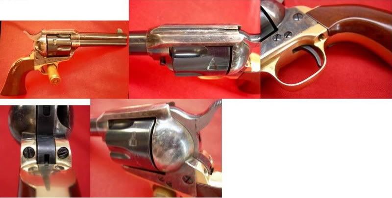

Check sent, and I got an email with pictures of the results 10-31-08.
I’m overjoyed.
My 31 year Iver Johnson’s Cattleman project is finished.
Oh joy, I’m like a kid on Christmas Eve, I’m anxiously awaiting the delivery of my rebuilt Iver Johnson’s imported Uberti made C45 Cattleman .45 Colt.
I can’t stand the anticipation.
Part two: The arrival and range trip; It's home!!! IJ Cattleman RANGE REPORT W/ PICS
The Cattleman got here today. Steve had shipped it out Wednesday the 5th. The last two days were like when I was a kid looking at the presents under the tree waiting for Christmas Day. My anticipation meter was pegged to the max.
I was following the progress on the Fed Ex tracking page and when I knew it was on the delivery truck, I looked outside every time I heard a truck drive by. Finally at 12:10PM I heard the truck I wanted to hear. I met the Fed Ex driver at the door and signed his scanner.
After that I sat down and worked like crazy to unwrap this thing. Steve had it wrapped well in bubble wrap and then in newspaper.
I examined it from muzzle to grips and was quite impressed with Steve’s work. I really had no idea it would look as good as it does. He was able to work 99% of the bow out of the top strap. What little bow is left isn’t visible, and unless you know it’s there you won’t see it. The fit of the rest of the parts isn’t too bad either. Considering the cylinder frame and barrel is over 33 years old and the remainder of the parts is a later vintage. Even the replacement front sight blends in to the point I wasn’t sure it was a new sight.
Fast forward to August of 2006, after much thought I contacted Steve Young of Steve’s Guns in Texas. He and I discussed various ways to repair this gun and so I shipped it off to him for an estimate in October of ‘06. The money I had for this got frittered away on other things so it sat in his shop for over a year. Then in April of 2007 with the govt “stimulus check” I was able to send him some money to get the project actually started.
At first I wanted to order all new parts and fix it that way. But that was just way too expensive. So Steve suggested he look for a donor gun and use the parts from that.
As much as I hate to part out a perfectly good gun to fix another one I said go ahead. It took quit a while to find just the right donor gun and then Hurricane Ike got in the picture, delaying things even further.
I got a phone call last week, Oct 27th ‘O8 from Steve. We discussed the project and he told me a lot of what he’d had to do with it. He said he was able to cold swage the remainder of the bow out of the top strap to within .005”. I said that should be close enough. Probably can’t even see .005” of bow. We were going to use the hammer from the donor gun, but the geometry wasn’t right. The timing was off. So he ended up repairing the original hammer. He told me he had to order an oversized base pin and cylinder bushing due to the fact the base pin holes in the frame were bigger than normal. And that he had put a taller front sight on per my request. He then asked me what we were going to do about refinishing the gun. I replied, nothing. Steve said the marks on the top strap are still there, so I replied; if you refinish the gun that will take away the marks. If the pock marks are removed, so is the story behind the pistol. That’s why I didn’t want it refinished. He also mentioned that the bluing on the barrel would be ruined when he put in the taller front sight. I said, I don’t care, I’d rather put up with that than have to aim at the ground to hit the target. Besides, I already have two .45 Colt revolvers with cold blued gunsmith custom taller front sights, so it will be right at home. Steve said it would be done soon, but he still had some parts coming in and he couldn’t say exactly when.
Last Wednesday, 10-29-08, I finally got the word, it was nearing completion. Send a check for the balance and it would be done pretty soon. Oh joy, WHOOPPIIIEEEEE!!!
I’m overjoyed.

My perspective on the various SAA's is from a gunsmiths view. Not what they cost or how well they retain their value. Purely from the mechanical perspective.
If you want tuff out of the box, Ruger is the way to go. Even though the New Vaquero looks very much like a Colt SAA I don`t consider it to be a clone.
This is a stainless New Vaquero with colt grips
The ruger lock works were designed in the 1950's. It is nothing like the colt style lock basically unchanged since 1836.
Comparing Rugers to colts is like comparing model T`s to 60`s muscle cars.
As for the colt style SAA's I think the current USFA gun are the very best SAA available today. The current colts are good guns too, but a few years back I had issues with some of the 3rd gen colts so I'm a bit gun shy toward colts. If their QC stays at current levels I may change my mind.
You mentioned the Berretta Stamepedes and Taurus gaucho's. Those guns have had some problems mostly related to timing issue and some have had small parts related to the transfer bar failures. Both the Berretta and the taurus are based on the colt style lock work but have had the add-on tranfer parts added. The colt style lock work is a robust design but does not lend itself well to these small delicate add on parts. Over the long haul these small parts don't hold up.
Comparing the Berretta Stamepedes and Taurus gaucho's to the Ruger would be like adding a catalitic converter and a smog pump to that Model "T".
As for the Italian SAA's, I think the EMF GWII's (made for EMF by Pietta) are the very best SAA coming out of Italy now.
When EMF decided to import these, Will Hansen, EMF`s manager sent one to me for a look-see. He told me take it apart, shoot it, whatever I wanted to do. These guns are late 2nd gen configured with 3rd gen style bolts with the rounded finger tips. This helps prevent premature bolt cam wear. They even have firing pin bushings like the originals but EMF did have them change the weakest link in the colt action, the leaf type hand spring. They changed to the Ruger style coil spring and plunger. The only add-on safety is the two position cylinder base pin. this part is easy to change.
The current Uberti guns are good guns. Uberti no longer makes there old "D" cam guns. These early Uberti guns were prone to go out of time prematurely. Uberti has up dated to the Ruger type coil spring for the hand spring. They are much better but aren't as close to the originals as the GWII.
Note,
Joe's IJ got the newer bolt and hammer. His old parts were the dreaded Uberti "D" cam parts that were prone to premature wear.

Here are a couple of images of one of my Rodeos after a couple of "treatments" with a de-rusting fluid (called Right Stuff Metal Conditioner) I bought at Advance Auto Parts. It took off the blue and gave the gun a dark aged mottled gray color and also gives rust protection. I used cotton swabs to apply the fluid and rubbed some initially to remove the bluing, then let fluid set on the gun for about 5 minutes and then wiped with a dry cloth. I took the gun apart to do the job so the fluid didn't get into spaces where I couldn't wipe it off. The longer it sets or the more treatments, the darker the gray. The gun is only a few years old but looks like it's "been there & done that". I have premium finished USFA guns and the Rodeo other than the finish is every bit their equal.kimwcook wrote:USFA says their Rodeo's are every bit the same quality as their high end models. It's just the finish that's different. The one I handled looked and felt like a phosphate finish. I didn't have the oppurtunity to shoot it. Someone on the singleactions forum took a Rodeo and used lapping compound or something like that and rubbed the phosphate finish off and it looked every bit a 100 year old gun. Looked really neat to me anyway.
BTW, azmark, the EMF Great Western II guns are made by Pietta, not Uberti.

Jim,
That's a pretty good aging job. I like it. Who made the grips?
Re: Tell me about your SAA clone...sorry, kinda wordy...
Joe,J Miller wrote:Jim,
Believe it or not, I bought those grips as a kit on eBay for about $18 and fitted them myself. The scanned image of the Rodeo makes them look more yellow than they are. They look more a creamy off white. They're certainly not premium grips but they feel pretty decent and I couldn't beat the price. The image below is of a recently purchased USFA SAA with optional CCH hammer; bought it from Gary Granger of USFA. I bought a walnut grip kit from Collins Craft grips - http://www.collinscraftgrips.com/kits.php - they turned out pretty nice. In case you didn't notice, I really like USFA guns. The new Colts are much better in quality than the earlier 3rd Gen Colts but Colt still can't seem to get the .45 Colt cylinder throats the proper size which is a pretty glaring problem for the price they're charging.

Both of my Ruger Vaqueros shoot to the same POA, and I've shot one-hole groups (standing, two hands, no rest) on more than one occassion with them. They withstand the rigors of CAS and the carry in ice and snow (not to mention teaching an actor to fan) with no ill effects.
The BH of course has adjustable sights. I did shoot it until it was battered out of time, but that was back when a plinking session was a 3lb coffee can of 250s over 10gr. of Unique. After five years of that kind of use (not to mention a thousand or more 250 JHPs over 21.5 of H110) I sent er back home to New Hamster, and in two weeks got er back all fixed, as good if not better than new, with a new bolt, new hand, and a recut forcing cone/barrel set back one turn. (no charge of course) You simply CAN'T do that with a colt or clone. They won't stand it.

I dunno,
It seems to me a gun that took several thousand rounds of HOT handloads and the "beating" meant recutting a forcing cone and replacing two small parts that were out of spec. to put er back to 1.5": groups at 25 yards TOOK IT just fine. A model 29 smith in .45 Colt woulda been in the junk box, and a SAA woulda likely cracked to pieces long ago. The vaquero is essentially the same gun, and I've run everything from 120 grainers at 600 fps to 318 grainers at 1300 fps through this one (LOTS OF THEM).
What WAS bad on it was the CCB finish that developed leprosy after repeated shooting with BP and maybe inadequate cleaning in the field.
I stripped and plum browned it 5 years ago. It's held up very well since.
