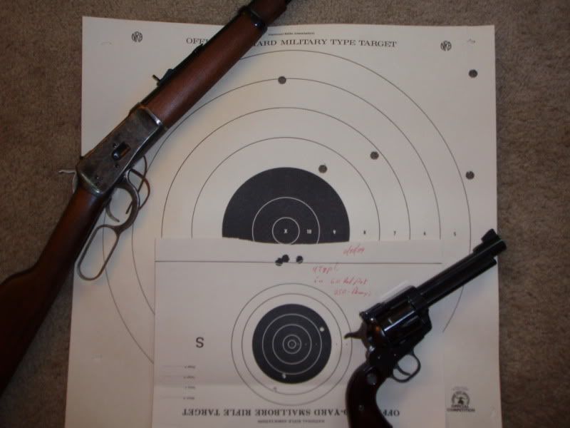

In the midst of my other topic was a problem that I would like to hear any feedback on.
I found that my Super Blackhawk which is OK but not great on accuracy will shoot very well with on of my standard 44 Special loads. See the target but the Rossi 92 Colt off the bench was terrible with a light 45 Colt load I use - as far as I can measure the front driving band of the 250 gr Keith SWCs and the bore are both .452". I will have to try other bullets - it doesn't seem to get along with this one. I love the rifle though.

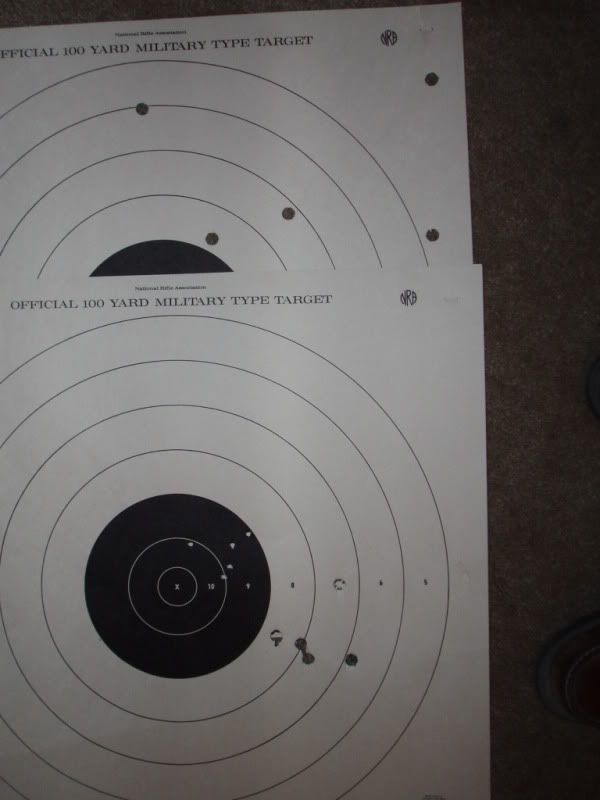

Re: Rossi 92 45 Colt accuracy? New results.
Went to the range with some reloads that measure .454 over 8.0 gr of Unique. Barrel had been cleaned and it was windy day, 110 in the shade at the range. But as you can see the group shrunk dramatically. It appears we have the answer. Cowboytutt is bringing some hot 45 Colt loads this weekend. 360 gr bullet over 18 gr of H110 .452 but they may obturate to make a difference. Bottom loads are the new ones.
OS,
I thought the larger bullet and would help. But those two groups are like night and day.
So just proves the point, Unique and .454" bullets is the way to go.
Well, the last part is JMHO.
Glad it's shooting better. Big Bubba over on The Ruger Forum chrono'd 8.0grs Unique with a 250gr Remington .455" factory bullet and his tests showed that this load was almost a perfect duplication of the standard traditional factory load. Here is his results:
OS, that's a drastic difference between the .452 and the .454's. Looks like you've found the right size bullet for that Rossi. Now, it's the search for the right powder load. Heck, with that last group you may not need to do that either. I don't recall your distance.

Posts: 16932
Re: Rossi 92 45 Colt accuracy update.
Well Tutt has come and gone here but he did bring some loads for the 45 Colt consisting of a Mt Baldy cast 360 gr Keith bullet with gas check over 18.5 gr of H 110. Velocity was 1345 - 1365 fps., center target. These as you see completely solve the accuracy issue, powerful too. Front driving band measures .453". He also brought some LeverEvolution rds. Looking at this group you will see that the first three rds were 5' triangle with a 1 inch group in the center of that for rds. 4, 5, and 6. Velocity ranged from 1109 to 1135 fps. This was shot after the lead and I am assuming that the jacketed bullet after three had conditioned the barrel in some way from shooting the lead. I also chronographed the 8.0 gr of Unique load from prior shooting getting approximately 1125 fps. These loads were all shot off the bench at 50 yds. Temp was about 100 degrees.
Thanks to Cowboytutt here for riding to the rescue - about 400 miles. He leaves me with a couple of boxes of this ammo. Guess he will have to be forgiven for missing the So Cal shoot in the spring that he set up.
