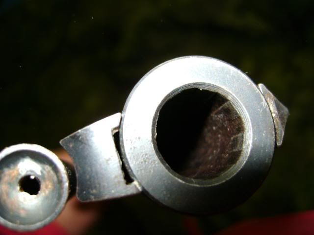

:?: Hey guys, I've got questions for the Wizards here. I recently bought a T/C .50 cal White Mtn Carbine at a yard sale for $ 30.00. The exterior is about 80-85%. The interior of the barrel is trashed, due to being shot about 5 years ago and put away without being cleaned. (see pics below) Do you think I could have this rebored to .54 or .58 cal? Or should I just look for a replacement barrel? It's 15/16" across the flats of the barrel if your wonderin'. Next question, what is your favorite conical bullet load ? Bullets at least 350 grains on up. Thanks in advance, Tom

I have a T/C Hawken .45 that same thing happened to, I plan on replacing the barrel with larger caliber. Chec out www.trackofthewolf.com They probably have what you want.

I would look at Green Mountain barrels - they used to carry replacement barrels for T/C muzzeloaders. You scored a good deal - some day I would like to own a traditional caplock muzzleloader and T/C makes a good product...

I would call T/C, to see how much $$$ the .50 Firestorm barrel with the 209 ignition drum would cost (which should drop in), and/or take a ride to NH and visit their custom shop - Fox Ridge Outfitters, 400 N. Main St, Rochester, NH (just off the Spaulding Tpke/Rte 16).

It would be MUCH cheaper and simpler to replace the barrel vs. reboring. Any barrel meant for the T/C Hawen (15/16 accross the flats) should drop right in. Green Mountain is a great barrel if you don't mind spending about $200. Check Track of the Wolf. You could also go on EBAY and pick up a used barrel. The .50 caliber for the Hawkens can be had pretty cheap.

The WMC is discontinued now, and some parts may be on the scarce side. Still, barrels will be available for a long time. The WMC was made with two different barrel twists: 1 in 28" and one in 48". The faster twist is only intended for sabots. I have a 'Gray Hawk': stainless/synthetic: a close equivalent of the WMC: wonderfully accurate at under 100 yards. I'd try cleaning the heck out of that barrel and shooting it. It could surprise you. Failing that, a 54 caliber replacement would be my next choice. I am pretty sure you can't substitute a barrel set up for shotgun primers on the caplock frame. Could be mistaken, tho; T/C or their custom shop, Fox Ridge, would be the people to tell you. I don't know why people want to use sabots and pistol slugs in their BP guns. I get wonderful accuracy, lots of fun, and game-killing power from my 50-caliber sidelock, using patched round balls. It's the cheapest and most traditional way to enjoy BP shooting. Of course I'm just an old stick in the mud, fuddy-duddy hard shell traditionalist, so take my remarks for what they're worth.

:) Thanks for the responses. Slab sides you really think cleaning is gonna help? If so I could have the barrel breached so I could clean it from the back end. Maybe if the entire wasn't rough. I'll mull it over, I have plenty of time between now and next hunting season. I wanted this for 75 yds and under hunting of pigs and maybe bear/moose. I intend to shoot heavy conicals (400+ grains) with loose powder. No sabots or pellets. Again, thanks for the answers, Tom

When I was cleaning my .243 this weekend I used JB bore paste and it worked really well.
It is abrasive, but not aggressivly so.
I do think that blackpowder steel is softer than modern smokeless steel, so keep that in mind.
Try some good blackpowder cleaner, then some JB,s ( in moderation )

I think a good scouring might give you a shootable barrel. Your pic doesn't look so awful A lot depends on how things
are way down deep near the breach. T/C is noted for their customer service...if you can't get it to shoot, before investing
nearly 300 bucks in a new barrel, I'd send it off to T/C (or drive it over yourself, you're not that far away) and let them look at it. I've heard that sometimes the Company will do incredibly generous things to owners of their product who are candid and up front with them. Tell them it's a yard sale bargain, and that you really want to resurrect it. They might just give you a new gun. Happened something like that to me once with a 'scope of theirs. Bought it at KTP, discovered in the parking lot that there was a big crack in the front lens (moral: be more careful examining 'bargains') drove over to Rochester and they gave me a brand new 'scope. How great a company is that?
I gather from some of the questions you've asked that you aren't too experienced with BP arms. When you contact T/C, ask for a manual for the gun. They are always happy to provide information to their customers.
