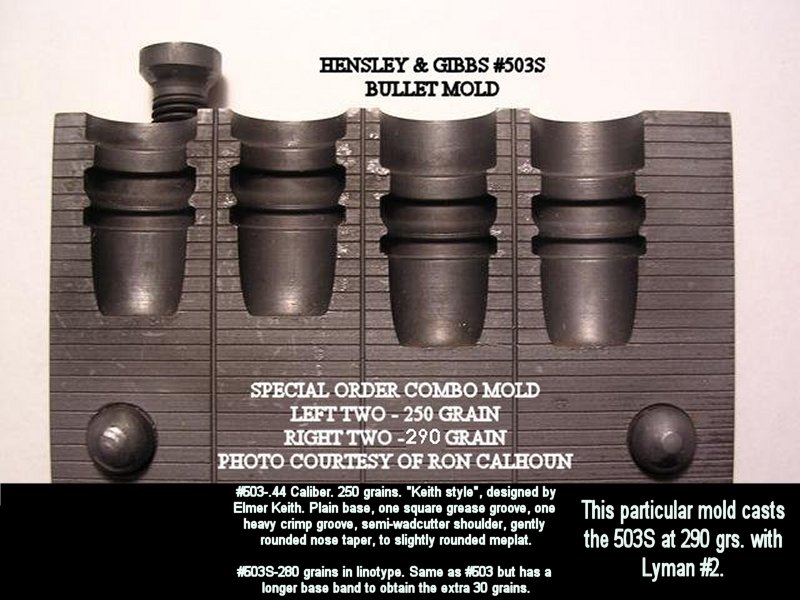

Ever see a mold like this
- Scott Tschirhart

When I heft a 4-cavity mould I want it to put out 4 at a time of the same bullet. Anything else is would be a pain in the posterior. I once had a mould cut that put out two plain-base and two gas-check of the same basic bullet. I have cursed myself ever since when I use that mould.

I can see a multi cavity that throws 2 different diameters, say 38 and 44. Sorting 4 different weights of the same diameter would just be a PITA.

I just wonder what would possess a man to order such a thing?

I ordered an Accurate 4 cavity aluminum mold with two 150 gr. and two identically shaped 250 gr. bullets for my .38-55. It is a real pain to keep the two sizes sorted, so I have taken to casting with just one or the other bullet to keep it simple. The mold pictured in the original post would be a nightmare!

Re: Ever see a mold like this
I never had one quite like that.
But, I did have a H&G 4 cavity that had 2 cavities of the standard #503 and 2 of the #503S. The 503 was the "standard" 250 grain Keith style 44 SWC but the 503S was 290 grain. The 503S had a longer shank below the lube groove but was otherwise the same as the #503. You couldn't tell them apart in a loaded cartridge, which I considered to be a disadvantage.
Both were accurate, but the mold ended up going to a H&G collector. It can be seen here: https://www.hensleygibbs.com/molds/503_240.jpg
