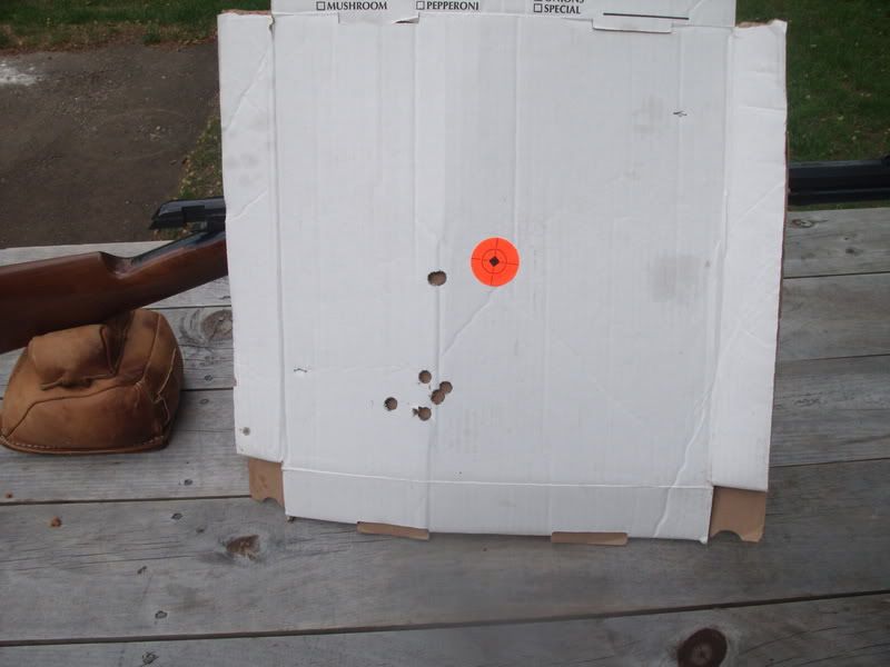

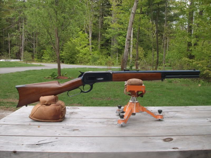

I took her to the range today just to see how she shoots cast projectiles. The load consisted of a stout charge of RL-7, W/W brass 2.10", Rem 2 1/2 primers, Mt. Baldy 405grFNGC bullets sized .460 loaded to a length of 2.30". I prepared the load using RCBS dies with a .454" expander. This size expander has proven itself time and time again with jacketed and high performance hard cast loads. A healthy crimp was applied with a Lee FCD. The top 4 shot group was shot at 40yrds with the factory open sights with the rounds loaded singly into the chamber. The bottom group was also shot at 40yrds from the bench but with the rounds loaded into the mag. tube. Must be some vibration thing going on with the rounds in the mag. tube. A total of ten rounds were fired today. Recoil was quite noticable to be sure. I did not chrono the load, too windy, but I would guess velocity was in the 1850-1950 fps range. Maybe I will post pics of my shoulder in a couple of days. Regards. 1886.

I thought that butt plate might bite a little :D
Shows some real potential though!!

Good enough. Seems it shoots minute of pizza. :D :D

That is a sharp looking blunderbuss you have there! Looks like the shorter length makes real handy in close quarters. Keep banging away and you will find a load that you like and eat one ragged hole at 50 yards.
Woe be to any game within range of you with that cannon.

I love the look of that rifle. very nice.

Boy, that's a handy looking '86. Iwonder how much difference there is shooting that length (20"?) and my 26"
Sweet rifle 1886 :D !As for recoil a ol "rule of thumb" is for every 1# less a rifle weighs expect up to 20% max more free recoil. :wink: Recoil velocity plays a role also.

if winchester made more rifles like that,perhaps they would still be in buisness. nice!!!!
That's a very handie looking rifle. Although, I'd rather stick with a 26" bbl. for the reduced recoil. Shooting that shortie with high end loads would definitely get my attention.

Very attractive '86 carbine. I liked it from the time I first saw the photo of it.

If it was me I'd be flinching like a girl after the first shot with your load, I ran a few figures through pointblank and if we assume 1900fps and 40 gr RL7( which is inside recommended range) and a 405 bullet, if your rifle weighs 7 pound you would get 41.5 pound recoil energy and 19.5 fps recoil velocity :shock: :cry: :cry:

Thanks for the calculations. The powder charge was quite a bit heavier than 40grs but certainly safe in the robust 86. This particular rifle weighs about 8.5lbs. No light weight to be sure. I do not think 40grs would register 1900fps. Thanks again. 1886.

Your right, 40 gr would only produce about 1600 not 1900.
