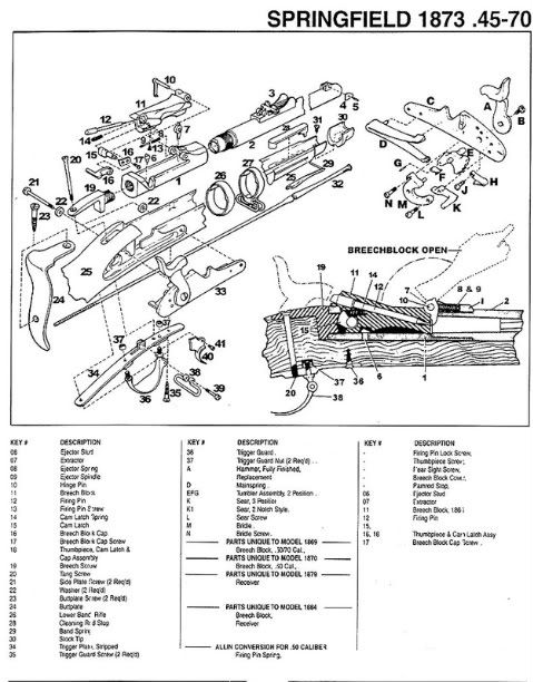

Kirk.. You have to be VERY careful if you pull the lock out of it's mortice..The fit is so tight that the wood at the edge of the mortice will chip out very easily.. You can reduce trigger pull by thinning the trigger sping...

A couple of other thoughts. If your going to disassemble the gun, and it hasn't been done in a long time you will have to be very careful with the screws. One crafty way of removing stuck screws is to place the gun in a vise or just a pad on a drill press. Using the right screw bit from a gunsmithing kit (exceedingly important!), place the bit in the drill chuck. Lower the ram into the screw slit, and SLOWLY rotate the chuck by hand. It will loosen the stuck screw without damaging it at all. A reall neat trick that was shown to me.
While you have the action out of the rifle, you can probably remove and take apart the trigger assembly if you have some brass punches. Then just polish the trigger mating surfaces and put a bit of grease on them. You could probably put a lighter spring in their too, but that will take a bit more work. I'm sure that trigger can be much improved upon.

Ben: Thanks for that tip, Ben. I'm kinda waiting until I've collected some good advice like that before starting to take it apart.

Kirk, yes as it has been stated, be very careful, the wood is tight around the lock and trigger guard plate. I loosen the screws about one turn and tap the heads with a plastic hammer lightly until the lock starts to move. Here is an exploded view of a Trapdoor. Since yours is a 1888 model your nose cap and bayonette are differnent, but the rest is the same. When you get the lock off, check the tumbler screws, if they are too tight they create quite a bit of tension on the sears.
Kirk, you also have a Buffington sight in rear and with it laying flat in point blank/battle configuration it is generally set for 250 yards! Flipping it up and you will get about 150 yards out of the lowest peep.
