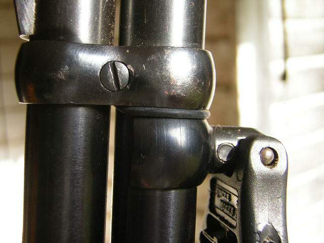

Put an o-ring on the mag tube ahead of the clamp-on stud. Then snug both against the barrel band. If you don't put an o-ring cushion between the barrel band and the stud band, something will eventually loosen. If your rifle uses a mag tube hanger, the hanger will eventually break without an 0-ring cushion--Voice Of Experience talking.

Just for those of us who sometimes have trouble visualizing things, could you post a pic of a rifle so equipped?

J Miller wrote:Junior,
Will do, Joe. I'll take a photo tomorrow after the sun comes up. In fact, I need to add the 0-ring addition to my 94 take down page.

Here ya go, Joe. A picture really is worth a thousand words. I took the mag tube to the local NAPA store and bought an o-ring that fit.

I've got a Winchester 94 with one of the Uncle Mike's sling adapters on it, and the front swivel base is clamped to the mag tube just forward of the forearm.
Should I move it to just behind the front barrel band?

TooTech wrote:I've got a Winchester 94 with one of the Uncle Mike's sling adapters on it, and the front swivel base is clamped to the mag tube just forward of the forearm.
Not without an o-ring buffer.
