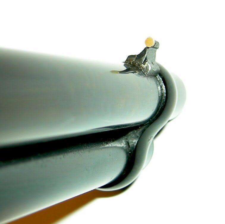

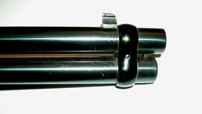

32-20 and 357m seems to be the preferred cals. Have you looked at the rossi octs? I've done a few of those now for folks using them for silly-wet.
I have even worked out a somewhat adjustable trigger for those guys.
The Browning 53 have a ramped front sight. Unlike the B92.
This is what I have been doing for the CAS shooters that send B92's for sights. Not the neatest job but I had to build them on the barrel without messing up the blue.

[quote="Nate Kiowa Jones"]
Dumb Question from me...what reason(s) are there not to mount the sight on the barrel band? Is it mostly because there would be some sideways/rotation possible?

Post by Malamute »
They are NOT stable. I had a Navy Arms .22 1866 carbine that was done that way. A good bump would have the windage off. It was frustrating because you generally werent aware of the problem until it showed up shooting at game.
