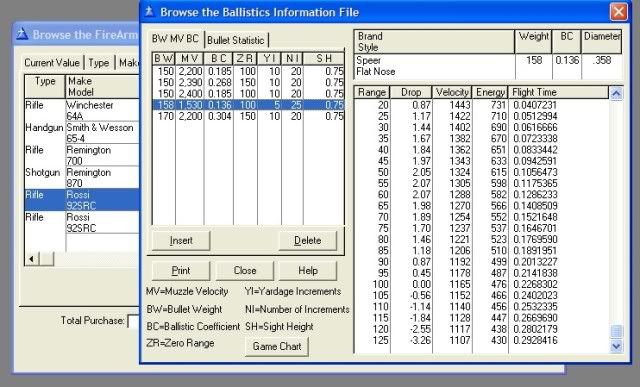

- Posts: 21210
Re: New Rossi 92 .357...Zeroing Question
As you can see, the highest point above the line of sight is 2.07" at about 50 yards... it doesn't fall below the LOS until your bullet is about 115 yards downrange. BUT, and this is where I choose my dead-on point based on the greatest degree of error in my range estimation, between 85 to 110 yards, the bullet path is only approximately 1-¼" above or below that line of sight; that's a 2-½" margin of error for your target area. Yet it gives you a 35 yard window of error for range estimation. And, with the bullet path never being over very slightly over 2" above the line of sight, you're still within minute of deer at any closer range!
As they say... "decisions, decisions... decisions!

As with Griff's chart, I would sight dead on at 100 yds.

Thats a great program Griff which ids it? Is it the one AJMD429 mentioned (RCBS.load v. 3.0).

Program is the "LEE Shooter" program. Provides for firearms inventory, reloading logs and several calculators.
