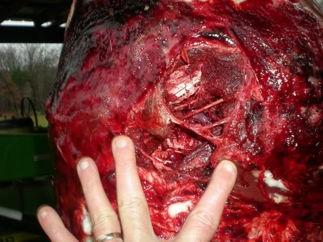

Re: .25-36 Marlin for deer?
25-35 from this year...
Ed
Ed
