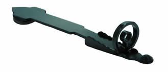

Image Image
(Note: red front bead is not part of either rear sight - just shown for illustration on the fixed one.)
If you got the fixed one, you may need to adjust the height of the bead on the front sight. The adjustable rear BullsEye gives you some hope of being able to use your existing front sight at some reasonable distance (50-100 yds) with typical ammo. But you still may have to adjust the height of the front bead in some cases.

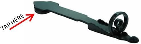

As far as removing the old rear sight, can't you just lube it up a little and "drift" the dovetail foot out sideways with a 1/8" flat-end steel punch? I guess they sell a special drift punch just for this operation. If my flat-end punch slips off the side of the dovetail, I will take a bigger one and grind the end to match the curvature of the edge (end) of the dovetail foot so it won't slip off when I whack it. Pretending that the new Marble Arms adjustable is your old factory buckhorn, here's where to hit it:
You oughta clamp the barrel well, with padding, and when you drift in the new Bullseye you will scratch up the blueing, so you may want to get a jar of blueing touch-up compound. You may need to take it to the range to get the final side-to-side adjustment right on the new sight, and again the only way to adjust it is to drift it. Finally, be aware that some dovetails are too big to fit into the dovetail groove and need to be filed down or are too loose and need to be shimmed from underneath with shim stock.

Before someone corrects me for advocating drifting out your rear sight with a punch (which will work and not do too much damage, with a soft brass punch), you can use (and should, if you can find/afford it) a hand press, essentially like a wheel puller, that grips behind the barrel and pushes the sight's dovetail base through the groove by you turning a threaded shaft, kinda like a C-clamp. I've seen them used for pistols, anyway, and I assume they make them for lever rifles. By the way, OF COURSE, a screw actuated press will be a heck of a lot easier when it comes time to make the slight left-right adjustments to get the windage right! :wink:
Re: Tang/Reciever sight Win 94AE
[I've seen them used for pistols, anyway, and I assume they make them for lever rifles.]
Several company's now make dupes of the original tool, the Williams Sight Pusher - but it's only good for ramped sight installations:
