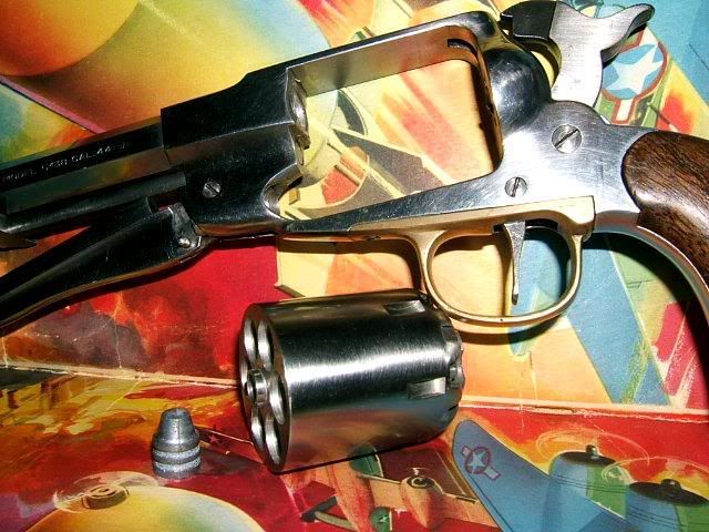

I can see the need for a Big Lube bullet in a rifle or carbine.. dont see any need for it in a revolver...I run a specially sized Saeco .452 180SW with ALOX all day long thru a Rem replica 44..Cylinder binding has to do with how well the pin is protected from fouling..not the lube on the bullet..

Posts: 2569
Post by Ben_Rumson »
How it's protected = How the revolver is made..Note the collar on the Rogers & Spencer's cylyinder face.. It fits UNDER the cylinder/barrel gap..fouling is deflected away from the axel pin, plus fouling has ahrd time making the turn to get past the collar and onto the axel pin, which I lube up with 1000 plus lube.. I modded the Rem to same config..Pin slides out with just a tap with a brass hammer after a day of shooting.. Note the cross pin I put on the Rem ram to give me uniform compression..The R&S uses the leverage of the ram to withdraw the axel pin..They both shoot all day with no probs..The Rem is the most accurate.. I sure wish I could afford a Fienworkbau ver. of the R&S
