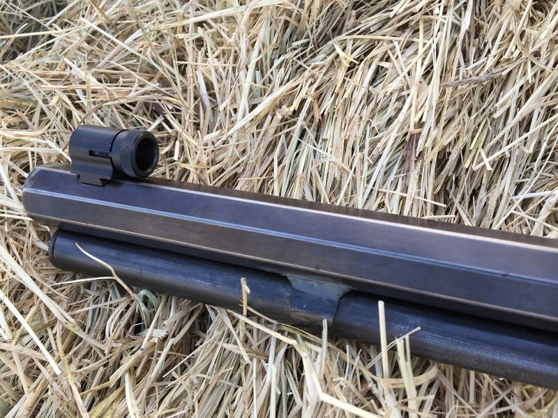

You might be right but it was all here today. Glad the old mail man came back today.
Now, which way does the front sight tap in from?

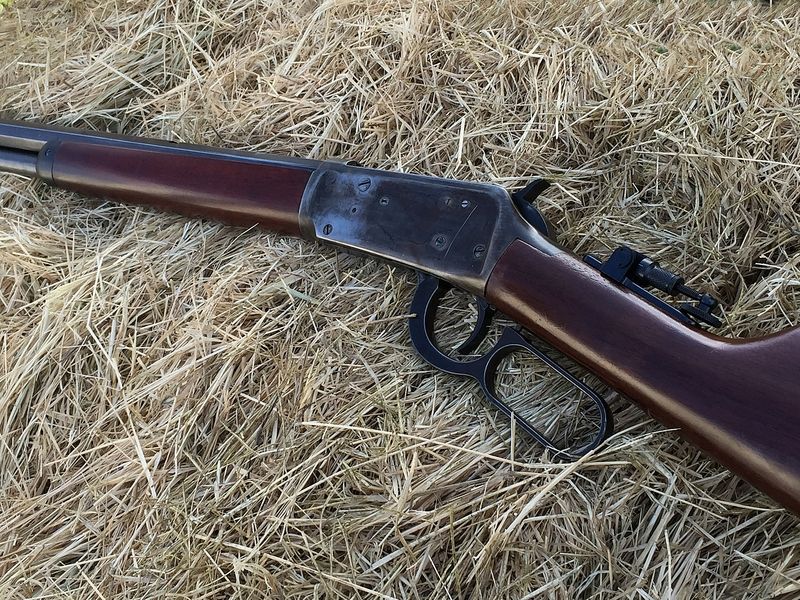

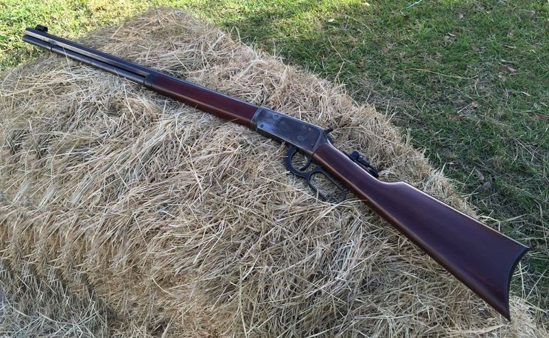

Well.....wish me luck. Planning on mounting the tang sight and Lyman 17A on the rifle and shooting some rounds for the first time in this rifle. Been a lone time coming.
- Posts: 21192
Re: 1894 build questions. Tang sights, stocks etc.
Good luck!Rube Burrows wrote:Well.....wish me luck. Planning on mounting the tang sight and Lyman 17A on the rifle and shooting some rounds for the first time in this rifle. Been a lone time coming.
- Rube Burrows
- Posts: 2169
- Location: Louisiana

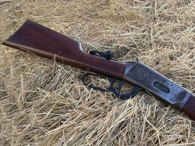

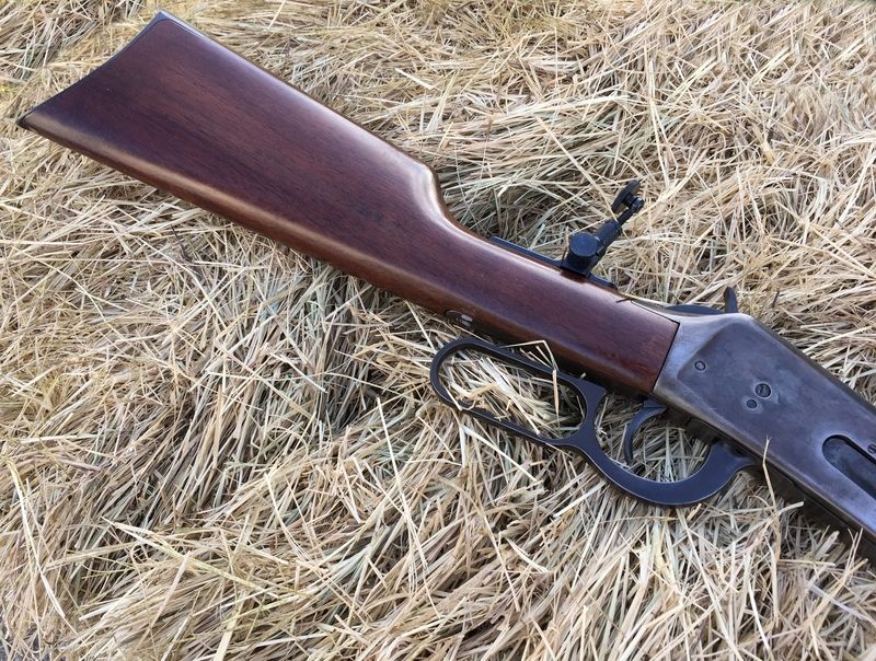

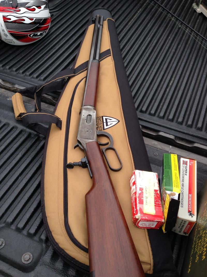

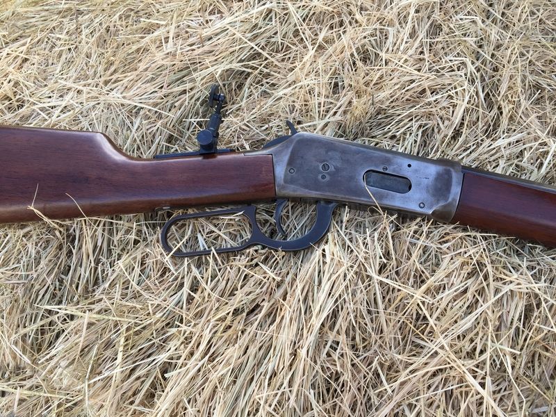

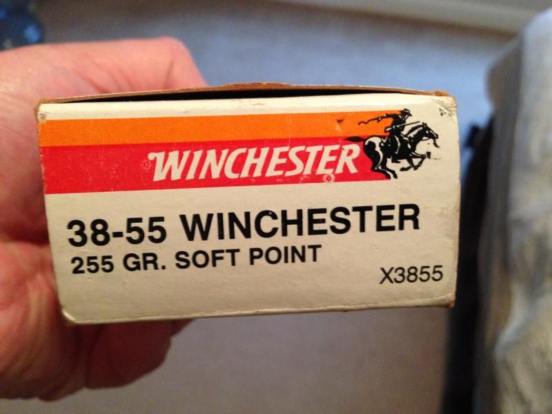

Well the rifle sights went on pretty easy.
The rifle shoots like a dream. It cycles like stuff.
Was mostly using Winchester (orange and white box) ammo but it was too long to cycle properly. Really shot well though. It was the first time I have ever had the chance to shoot 38-55 and I really like the caliber. Just have to get the feeding issues worked out.

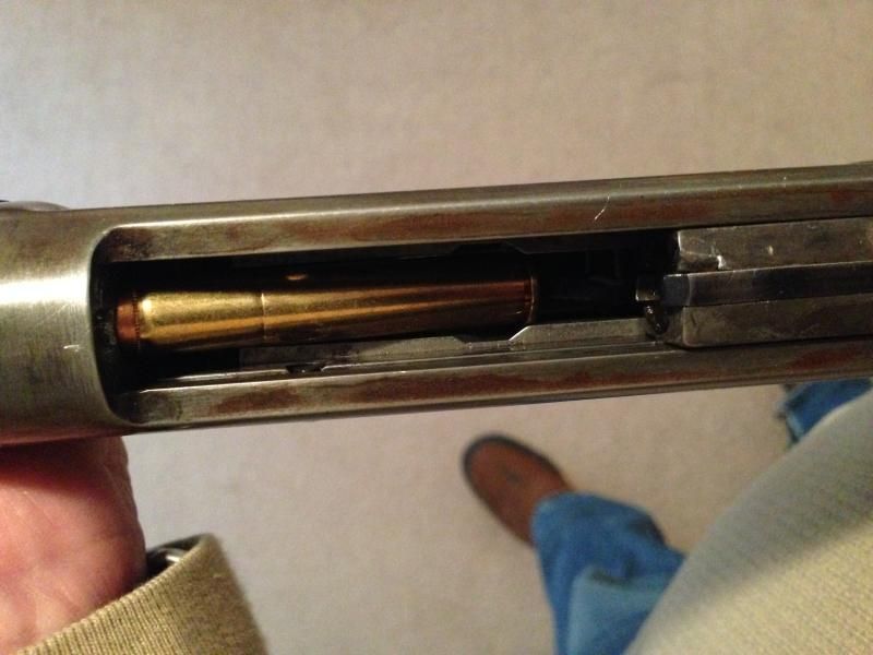

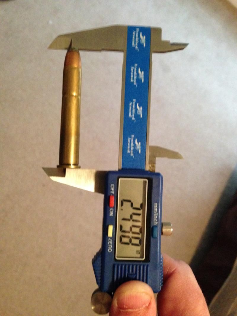

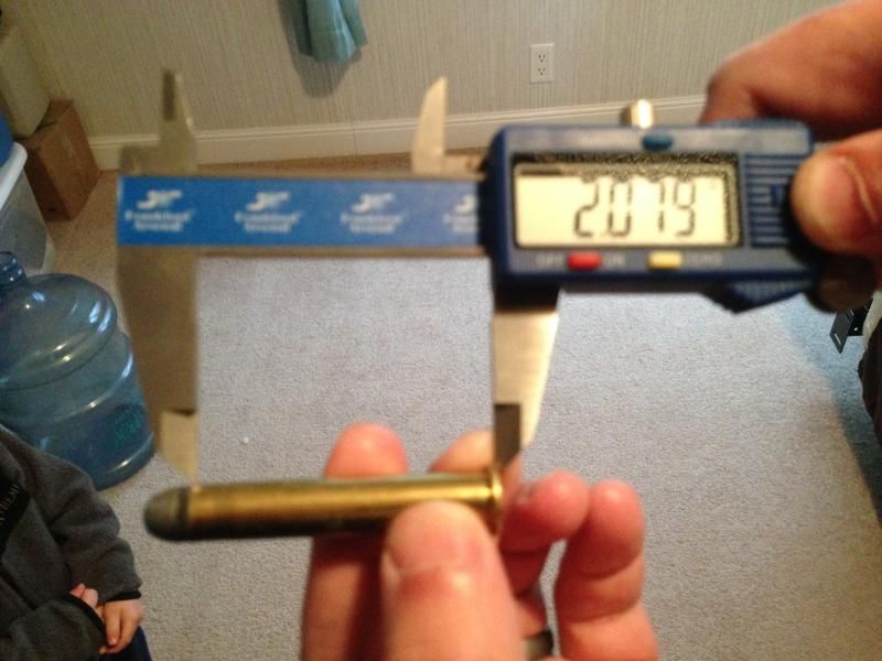

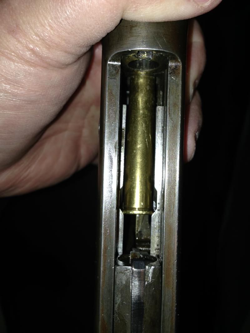

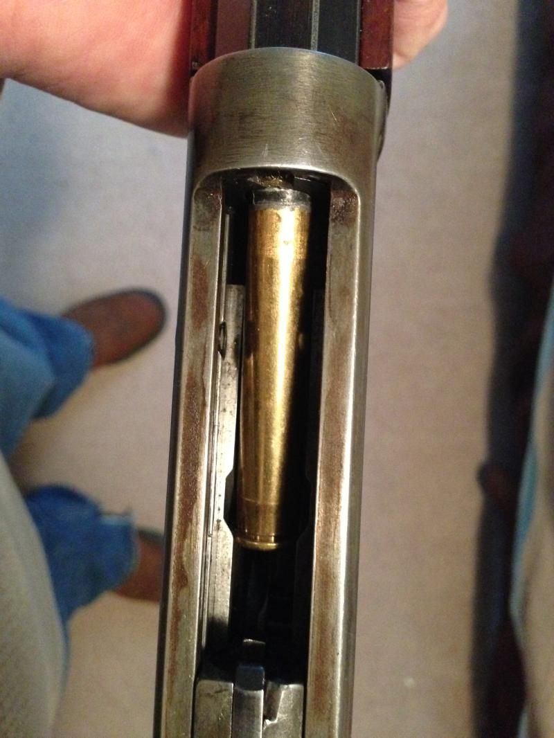

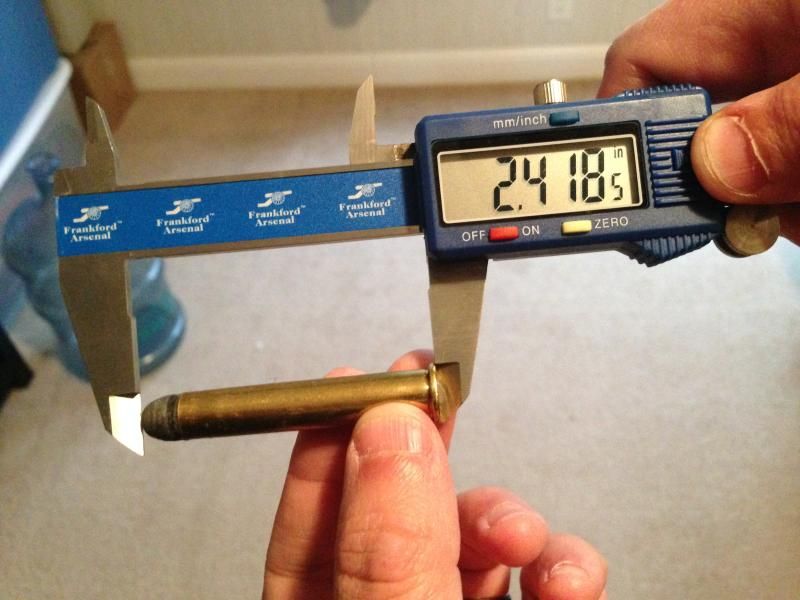

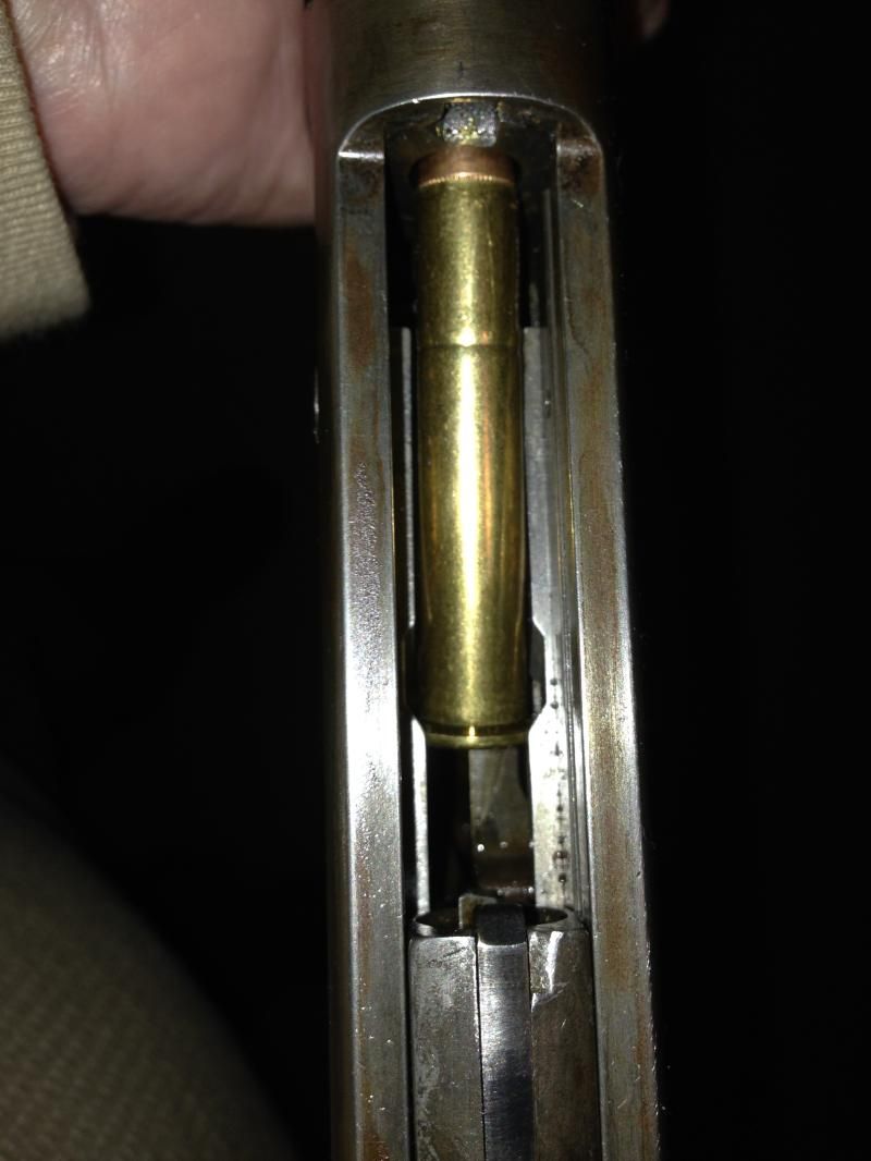

Okay, maybe these photos will help.
First photo shows how its getting stuck
This is the type of bullets they are above.
These photos show the overall length and the brass length
I also tried some of these Hand Loads that were traded to me.
It looks like when its pulling the round out of the magazine about half way it seems to sometimes come off the extractor.
Maybe the ramps are not pushing the round up like it needs to be.
- Posts: 21192
With the bolt fully to the rear, the rear of my cartridge slots measure .665" forward of the bolt. Although a .30-30, my COAL is 2.465 and brass length is trimmed to 2.020 after sizing. It appears as though your carrier may be coming up too high, forcing the nose of the bullet into the top of the chamber...
Or, if not, your slots are too far forward, not letting the rim come up fast enough. That would require taking them out and using that favored tool of all professional gunsmiths, a Dremel to the lower, back end of the slots to allow the cartridge rear to come up thru them earlier.
20Cows has done a conversion of a .30-30 to a .38-55 with one of his "Puzzle" guns... maybe you can PM him and ask for any advice. Someone else here has also... but, I can't think of their name right now.
Nice looking rifle!
It looks like the entry to the chamber is perfectly square. You need to round off the edge. Even a 30-30 will not feed well without rounding off the back edge of the chamber. My Model 94 in 444 Marlin has a big radius on the bottom of the chamber to allow the long bodied cartridge to feed. Take a look at some other Model 94's to see how much to round it. You may not need to touch the cartridge guides at all.
I took a picture of the 444 chamber for you. The bar of light at the back of the chamber is reflected off the bevel that lets the cylindrical case enter the chamber far enough to clear the cartridge guides. As you can see that is a pretty big bevel and I wouldn't bevel the chamber on a 38-55 that much because the 38-55 case is probably thinner than the 444 case and it needs a little more support there. The picture should give you a better idea of what I am talking about.

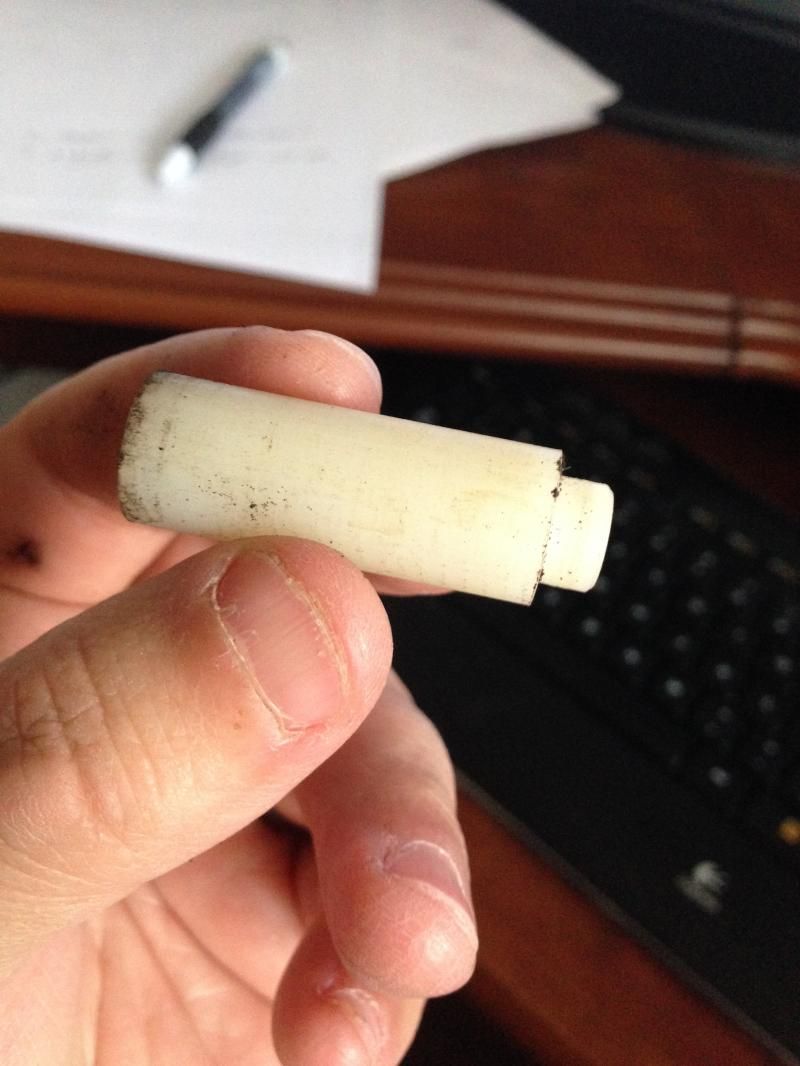

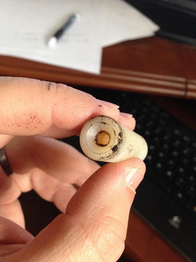

I thought maybe I had my magazine follower in backwards and that maybe it was not giving my ammo the resistance it needed to seat properly on the bolt so I pulled it to check.
All of my other Winchester 94s had a metal follower that looked kind of like a thimble but this one is different. Did I somehow mix it up with another project?
When I got this doner 94 for this project it was basically just a bunch of parts. This may not be the correct follower. What do you think?
Even still, that may not have any thing to do with the feed problem.
- Posts: 21192
Yep, I think you mixed up some parts. That ain't a mdl 94 follower. Should be metal, with a convex face. I don't have a pic of one. Wouldn't think that'd be the problem, unless you only loaded one round and that is pushing up on the underside of the carrier.
- Rube Burrows
- Posts: 2169
I'll have to look and see if I have one of the metal ones. I'm thinking that may have been the stock one out of a Rossi 45 colt that I replaces with a metal one.
Maybe this rifle didn't come with one when I got it since it was all apart.
I only loaded 3 rounds in it when I shot it and only the one for the photos above.
- Posts: 21192
There is a lip inside the front of the receiver that mates w/the corresponding shelf on the follower keeps the follower from protruding too far inside the action. This would lock up the action, as there's nothing to push the follower back into the mag tube. Which end did you have the spring on? I don't know the clearances in the action, but you could be getting some interference.

Well honestly I have not had time to mess with it but since you pm'ed me I felt the need to get it out and I will try to get something done soon.
I did shoot a few better photos of the gun though.

I kinda like the the replica Lyman 5, or Beach/Beech Combination front sight. Here is a link but a quick search reveals lots of info. Buffalo Arms sells some as well under Red River trade name.

Congrats on a nice build. Folks often report good accuracy from the octagon barreled Winchesters. Sounds like yours is a good shooter.Canuck Bob wrote:I kinda like the the replica Lyman 5, or Beach/Beech Combination front sight. Here is a link but a quick search reveals lots of info. Buffalo Arms sells some as well under Red River trade name.
https://montanavintagearms.com/product/ ... ont-sight/
- Rube Burrows
- Posts: 2169
Canuck Bob wrote:Congrats on a nice build. Folks often report good accuracy from the octagon barreled Winchesters. Sounds like yours is a good shooter.Canuck Bob wrote:I kinda like the the replica Lyman 5, or Beach/Beech Combination front sight. Here is a link but a quick search reveals lots of info. Buffalo Arms sells some as well under Red River trade name.
Thanks. Shoots great. Cycles bad though and I haven't been able to quite figure out why.
Have you done anything with the rim slots in the cartridge guides yet? From the pics, that looks like the likely culprit. A note to Steve of Steves gunz or Mike Hunter may be worthwhile also.Rube Burrows wrote:
- Rube Burrows
- Posts: 2169
Malamute wrote:Have you done anything with the rim slots in the cartridge guides yet? From the pics, that looks like the likely culprit. A note to Steve of Steves gunz or Mike Hunter may be worthwhile also.Rube Burrows wrote:
Im not exactly sure what you mean. I did order the correct magazine follower. Other than that I have not done anything yet. It was put on the back burner for a while but I took it out the other day and hope to get it figured out soon cause it shoots great from what little I have shot it so far.
That incorrect magazine follower will only matter when feeding the last round, assuming it moves through the magazine tube OK. If it acts the same with two rounds in the magazine and both fail to feed well off the carrier, its an indication the follower wouldnt be the sole issue. The earlier discussion looked like the cartridge was binding when trying to feed into the chamber.
The rim slots in the cartridge guides were discussed above. With the top front edge of the cartridge binding on the chamber when feeding, it looks like the rear of the cartridge may need to raise sooner in the feed cycle. I think a note to Steve of Steves Gunz, or Mike Hunter may be useful in figuring it out.

Thanks. I am not sure what I could do to them though. I may need to take your advise and contact Steve or Mike.
- Posts: 21192
What Malamute said on the follower. But as for the guides... I'll tell you it's trial and error. In the below pic, you would be removing material where the red pointer is. You only need to remove enough to allow the rim to pass thru the guides a little sooner... or at a lesser angle that those factory guides.Rube Burrows wrote:Malamute wrote:That incorrect magazine follower will only matter when feeding the last round, assuming it moves through the magazine tube OK. If it acts the same with two rounds in the magazine and both fail to feed well off the carrier, its an indication the follower wouldnt be the sole issue. The earlier discussion looked like the cartridge was binding when trying to feed into the chamber.
Did you measure between the bolt face at its rearmost position to the back of the cartridge guide slots?
(the #21 is the front of the guide for positioning reference).

Hard to see the photo cause its small but I think I know what you are talking about. I will try to measure it this weekend and get something done on it.Griff wrote:What Malamute said on the follower. But as for the guides... I'll tell you it's trial and error. In the below pic, you would be removing material where the red pointer is. You only need to remove enough to allow the rim to pass thru the guides a little sooner... or at a lesser angle that those factory guides.Rube Burrows wrote:Malamute wrote:That incorrect magazine follower will only matter when feeding the last round, assuming it moves through the magazine tube OK. If it acts the same with two rounds in the magazine and both fail to feed well off the carrier, its an indication the follower wouldnt be the sole issue. The earlier discussion looked like the cartridge was binding when trying to feed into the chamber.

That ol gal is very photogenic, you done a better job on your wood than i did on mine looks like

Take your cartridge guides out, one screw on each side, wait try to chamber a round, look at the head of the cartridge, take a mental note of how much needs to be filed of each side, this will be at an angle toward the chamber, now take the guides out, one screw each, file with a triangle file the amount that stuck in your brain, count the strokes, do the same on the other one, clean up and reinstall, it took 8 strokes on mine, it feeds perfect, the guides can be taken out and put back in without disassembling the whole thing

Rube, check to see if your carrier isn't coming up too high. Here's a couple of pics of a couple of my .30-30s I took to show where the carrier should be in relation to the chamber mouth, (top, a pre-64, bottom, a post 64):
I don't have either rifle with me to measure, but you should be able to see that the carrier sits in a line with the chamber mouth; if yours is a little too high, you can trim it down a mite to allow the front of the cartridge to drop a bit, and get a little further into the chamber so the rim clears the slots. Lay a pencil or other smaller straight edge on the carrier that will allow you to see if the carrier lines up with the mouth, with enough clearance to get the case past the mouth, yet not so high that the bullet hits the top of the chamber before the rim can clear the slots in the guide.
FWIW, the later mdl 94s all have the same part number for guides for all calibers, very early ones used a different set of guides for the .32-40 & .38-55. But those are for a pre-64 type receiver, which are threaded to have the screw heads inside the receiver... so those guides would fit in your gun. If you could find any, I certainly haven't for my pre-64 receiver.
