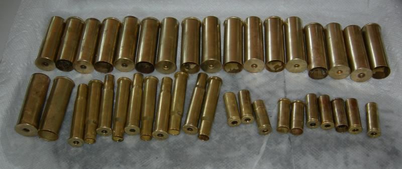

Ok, ran a second test, using the 10 .40-90SBN and 10 .45 Colt pieces of brass I shot at the range on Tuesday afternoon along with some Magtech brass 12 ga shotshells that had been shot about a year ago... all had been loaded with BP. The 45 Colts and 12 ga w/Goex "Cartridge" and the .40s with Swiss #1-½.
I decapped everything before putting it in the Sonic Cleaner. Used the Hornady "One Shot" cleaner and just over 40 oz of water to 1 oz of cleaner. Had to add a bit of water to have everything submerged... Total time in Sonic cleaner, 16 minutes.
I forgot to take a "before" picture... but suffice it to say the .45 Colt was dirty, as it had been shot with BP before and was quite stained. the .40 cal. cases had been cleaned in the sonic cleaner before loading, and were as pictured in a previous post... and after firing with the Swiss, were not all that badly sooted. Inside the case, yes, but this load seals the chamber nicely and only a couple of cases had any stain on them left from previous firings. The shotshells had been decapped and soaked for several days in dishwasher soap and water, then dried.
After 16 minutes in Sonic Cleaner with a warm water rinse, before drying:
As you can see, there's a little discoloration from the heat of drying them in the oven. However, from past experience, this polishes right out after an hour or so in the vibratory tumbler. I'm quite hopeful that maybe I found the right process. If the tumbling does that discoloration off, this'll become my new routine for all my BP brass.
I'm headed off for Washington state this afternoon, so they'll have to wait till I get back to get tumbled. Stay tuned for the next installment.
After drying for 40 minutes @ 170ºF:

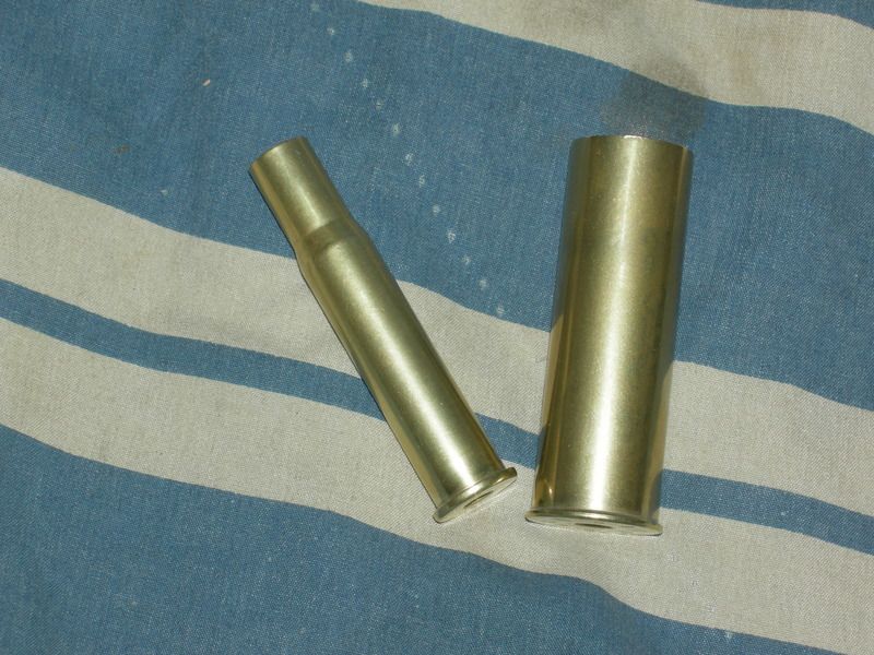

To continue from previous post... I turned on the tumblers last nite and let them run till this morning... I'll post a pic a little later, but.. other'n very faint stains, they look NEW! Almost all the discoloration from the heating is gone. I just removed one 40-90 and 12 ga case... so don't expect a pic of a BUNCH of shiny cases!

Now:
After just the Sonic bath and warmed up to speed drying:

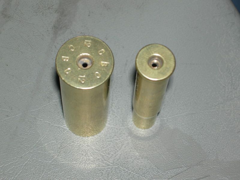

Remember, these were loaded with Goex BP. When I stop again, I'll try for a pic of the primer pockets. I've NEVER had primer pockets this clean with just tumbling, even smokeless rounds!
