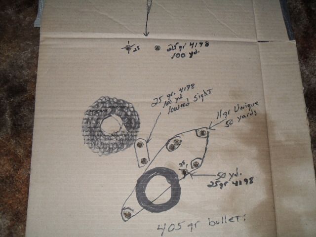

45-70 dies will work fine. Get away from the .457 cast bullets. If thats the diameter of your bore and with the perfect smooth condition of the bore, you are not creating enough build up pressure. Go to a .459 diameter bullet and shove 11 grains of Unique in the case. Get rid of the junky sight and install a good tang sight with a flat black bead or flattop sight for us old heads.
After you shoot an expected 1-2" group at 50 yards or a 3" max at 100, go to 5744 as 4198 will give you large extreme spreads (with light loads) , especially in cold weather when you decide to hunt. 4198 works great if you have the proper conditions for a pressure build up, but with light loads in cold weather, its worthless. You might get 15 in a row that are fine and then when you pull the trigger on the 14 point, you might get a hangfire---with the light loads, mind you.
Unique will give you all you will ever need or want. (12-1300) and will get perfect ignition without any stupid case fillers. A 300 grain bullet will travel (at 1300) through anything in North America at 100+ yards which is about all you and I can see. 5744 is the next best, if not the best powder for the big cases as it has a high nitro content. I only use about 10-12 pounds a year so I hope I got it right--------------------------------------------Sixgun

All so much to decide about, i thought the 4198 was the ticket and i like the 405 bullet.
Heck it`s gotta be just as reliable as my muzzle loader that goes off most the time. :lol:
Thanks for the info and sorry for getting impatient Hobie. :oops:
Also this gun came with a brass blade front sight that glares and is hard to see sometimes so i blackened it and seems better.
Will try a few 100 yard shots.

The '76 is doing great. Don't forget aout the all time load using Unique at sub-sonic speeds. In the 45-60, 11 grains will push it about 1100 with a 400 cast---loose in the case.---------------Sixgun
Sixgun i see in this reply you mentioned using a 400 grain bullet, maybe i`ll try a few of my 405`s and see how they shoot.
Unique would be a good powder and get a little better milage per can.

Unique is an excellent cast bullet powder for low velocities. Its usually not recommended because of the danger of double charging a case. Just throw it in loose in the case with no stupid time consumming fillers. About 11 or 12 grains for the 45-60 with either a 300 or 400 grain bullet. A pistol primer will be fine.

Like i said these bullets weigh in at 405 grain, i just loaded five at 11 grains and will shortly go shoot them and see what they do.

Pitchy, IMR 4198 is one of my favourite powders, but I think Sixgun may be right about spreads. That being said, I am planning to experiment with dacron filler in my 45-60 using IMR 4198 and 5744 later this summer. Dacron filler will greatly reduce extreme spreads with IMR 4198. I also know that IMR 4198 plus filler is a favorite with Sherman Bell. With the kind of shooting you are doing, you might really enjoy a Chrony. It will tell you a lot about what is happening. As for now, looks like you are right on the money with load.

Thanks Kirk, i`ll go shoot these five with Unique in a minute and see how they feel, i am pretty happy with the 25 grain load with the 405 and the 30 grain load with the 300 grain bullet.
Results within the hour. :)

Sorry Sixgun but no go with the Unique, maybe because of the bullet diameter.
The 25 grainload of 4198 and 405 bullet shot a decent three shot group high at 100 yards, the middle hole just skimmed over the cardboard as it was folded over on the top.
Lowered the sight one notch and shot two more at 100 yards, not bad.
One at 50 yards.
I think i`ll stick with the 4198 for now, thanks for the help guys. :)

Wow! I'm impressed with those two 100 yard groups. That 3-shot group looks like it might be 2 & 1/2" and the 2-shot group looks like 1 & 1/2". Not too shabby at all! In fact, I would call that excellent.

Whoops sorry, the top three in group measures two in. and the other measures 1 1/4. :D

Your smokin' now Pitch! :D To fully appreciate an excellent load and to have confidence in it, there should be a minimun of 10 shots fired---nice and slow...5 shots is childs play.........15 or 20 will really show the load's capabilities. 50 yards tells very little with rifle loads. I can't begin to remember how many loads I have had that shot great at 50, but were dismal at 100.
