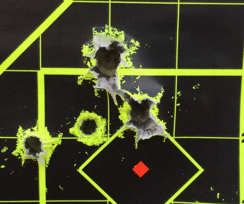

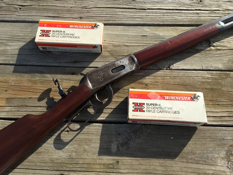

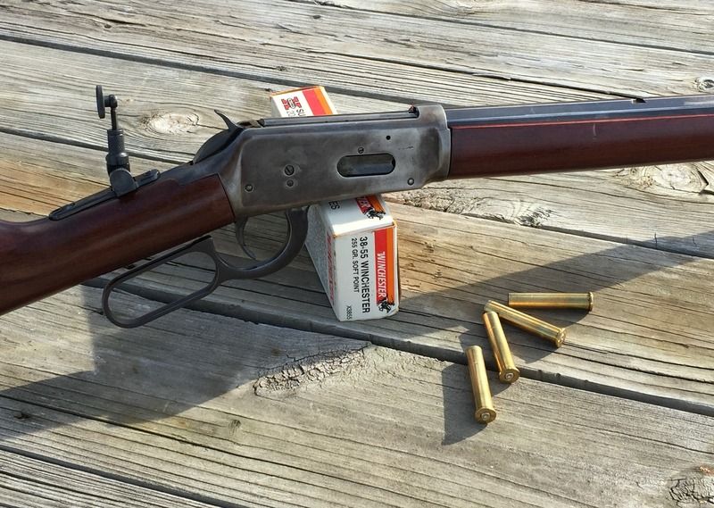

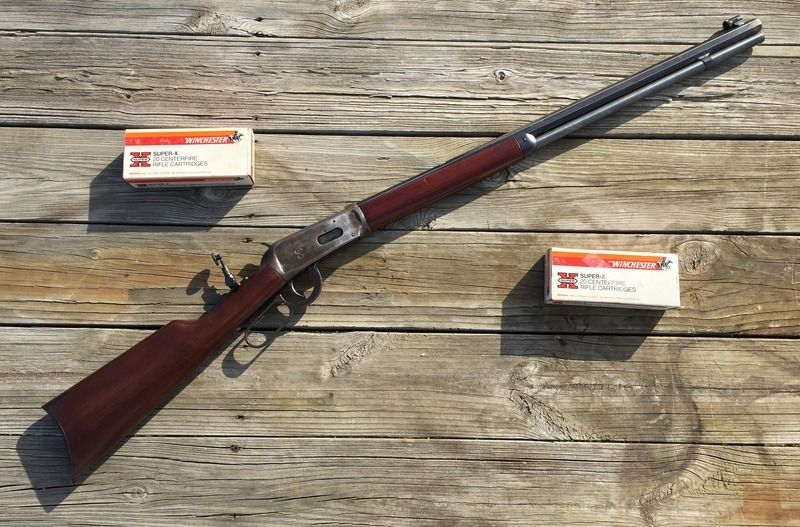

Got the cartridge guides filed and now it runs great. Here are a few photos from today's shooting.
And here is the best four shot group I got.
I ran out of upward adjustment and need more practice adjusting the sights. Several times I moved it the wrong way and then had to track back.
If I remember correctly, my sight came with another post that was taller. Hopefully so cause I could not adjust up anymore and at 100 yards was shooting low.
