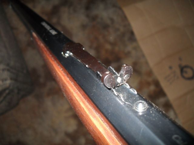

New buckhorn sight came today, stamped out piece of junk, elevator was just about as thick as tin and the sight bent when lifting it up to put the elevator on.
The 60.00 buck piece of junk went back for a refund.

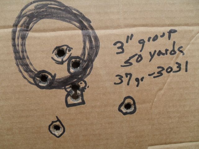

Here`s the results at 50 yards with 37 grains of 3031 and 300 grain bullet, a little better but still not great.
I ordered another semi buckhorn sight on ebay that has the adjustable blade with the white diamond in it and double sided elevator.
Will report back when i get new powder and sight.
The 60.00 buck piece of junk went back for a refund.![]()
I did get the hammer spring and lever safety spring lightened up so it shot easier.
Had to order a can of 4198 powder so can`t try that yet.

If I'm guestimating rightly, five of those shots went into about 1 & 3/4" at 50 yards. That is not bad at all. In fact, I'd say it is encouraging. A better sight combination coupled with a faster powder like IMR 4198 might tighten that up enough to give your sub-3" groups at 100 yards. You might have mentioned this already, but have you considered a tang sight? All in all, that ain't bad.

Thanks Kirk, yea i`m lookin forward to try the 4198 powder and sight.
The only rifle i have a tang sight on is my Sharps, i can`t seem to get used to them when carrying the rifle .
I think a normal notch in a buckhorn type sight will help alot, the wide V in this ladder sight leaves to much room to move around.
Not to knock a original ladder sight as i believe they have a better notch in them.
It will be at least the weekend before everything gets here.
The safety lever spring was so stiff that it actualy put a weird twist on your hand squeezing it and trying to hold steady.

Pitchy, I hear you on those wide v notches on the ladder sights. I have a problem with those as well. The notch is so wide, it is hard to tell when the dadgummed front sight tip is centered in that wide valley. A buckhorn sight will certainly help, at least in my opinion. (that link to the '76 articles is a good one. I didn't now about that one.)

Ok, new sight on and still all over the place with 3031.
So it`s either the powder or my eyes and bad shooting but the shots felt pretty darn good.
I set the sight so it shot high at 50 yards but what surprized me there wasn`t much drop at 100.
As soon as i get the 4198 powder i`ll try that and update.

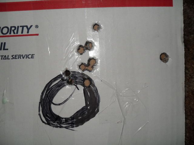

Well boys i had 11 cartriges left with the 3031 load so set up a target at 30 yards at my garage range.
Sand bag rest and look what happened, not bad, one flyer so i`m thinking the problem is my poor eyesight.
Will still reload some with the 4198 when i get it and shoot another group at 50 yards.

You have a lot of rounds clustering pretty tight there. That is looking promising. I'd say it is probably your eyes that are the challenge, and trying to get that front bead level with the top of your rear sight when it is fuzzy. I have the same problem. One way to cheat is to take a little sticker, punch a tiny hole in the middle of it, then stick it to your glasses or sunglasses so that it acts as a peep sight. That should sharpen up that rear sight. I do it on a regular basis and it works well.

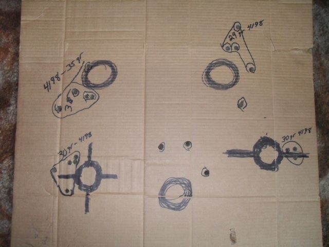

Ok Mike i tried some loads with 4198 starting at 36 gr. then 38 then 35 and they went all over the target. Kicked like a mule also so to heavy for my blood.
Tried 29 and 30 grains, 29 being what the lyman manual calls for and ended up with 30 gr.
Nice mild load that`s pleasant to shoot and should be running about 1400 fps.
Shot 31 loads all together with no failures to fire.
Some of the holes from the heavy loads were more than a foot apart and had to set the sight up two notches.

Re: Chaparral 76 range report and new outfit
30gr looks great
Thanks Pete, the groups all shot to the right, i flipped the target over in the middle of the shoot.
I bumped the front sight to the left a hair so should be close now.
I`d think that load should be plenty for deer don`t ya think.

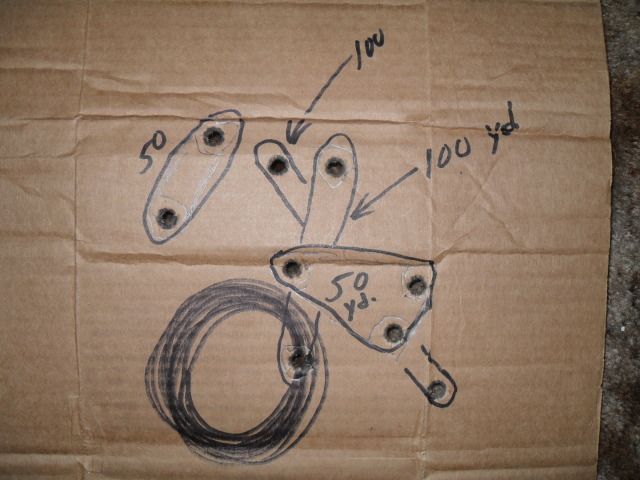

Whoops, all shooting was at 50 yards off a sand bag.
I like the powder it burns real clean with no unburned powder anywhere.
A few of the cases had soot on them about a half inch down but most were clean.
Is that from loading with 45-70 dies and they are full length sized too much or because it`s a mild load.
30 gr. goes with the 40% rule. I still use CCI250s with mine, just simplifies things as I experiment. I had to raise my front sight by way of modifications (which I suppose I should publish) to get my SRC to shoot to the sights.

Here`s a load i just tried out using a 405 grain FN bullet over 26 grains of 4198.
Mild shooting and fills the case right up too the bullet, if a good set of eyes would of shot that would of been a tight group.
As i have this mold i may stick with it, should be a dandy deer load.
This was at 50 yards, should be right close at 100.
Copy any loads in this thread at your own risk.
In my own case, vertical spread like that is due to a blurry top of the rear sight, making it difficult to see exactly where to put the top of my front sight. If that is the case, you have yourself a super accurate load. Did you shoot that on a cloudy day or in bright sunlight? I find I shoot much more accurately in bright sunlight due to my pupil stopping way down to a pinhole, which sharpens everything up real nice.
It seems to me that the repro sights are much less sharp than the originals and this affects how well I can use the sights. It does look like a good load!
It was sunny but i was in kind of a hurry to test fire the load , that and the fuzzy sight picture.
I made up another 50 cases yesterday so i`m going to load up some at that load and see how they fly.
Will update tomorrow.
Got out to shoot today, good as these eyes are going to shoot.
2 1/2 in at 50 yards, good enough for deer.
26 grains of 4198 -405 grain bullet
Dropped the charge to 25 grains, bingo, and a little more mild shooting.
