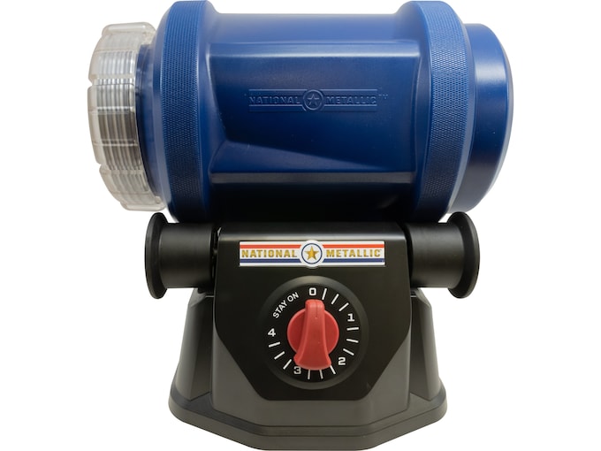

A few weeks ago a friend told me that Midway was having a big closeout sale on National Metallic wet tumblers that were large enough to hold 1,000 .223 cases! Normally $130 for $50, so I bought a 2nd wet tumbler that allows me more capacity, plus if I have two different cases to clean I can run both of them.
The big advantage (beyond size) to the National is the drum has a shape design that does a better job than my Lortone to turn and mix the brass and media up. So it takes less tumbling time to get the same result. The negative is the lid once tightened down is a little more effort to break loose vs. the Lortone that's a single wingnut. But I really love the timer on the National, so I don't forget to turn it off like I have on my Lortone.
