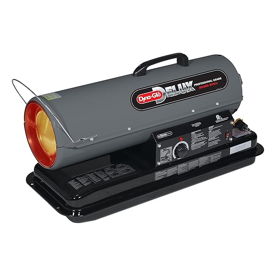

It looks like your home isn't heated by an oil-fired furnace/burner, or you might be able to extend the house's current heating system. (that may require a BTU upgrade to the house furnace, though)
An alternative might be to purchase a portable indoors kerosene heater (about $200, below, for 80K BTU's), like home builders sometime use in cold areas.
