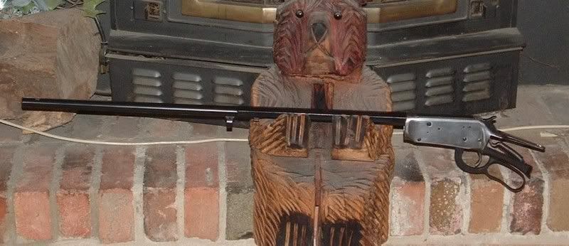

Here is my "trapperize" Model 94. Might give you some ideas.
http://onesticky.levergunscommunity.com ... rsion.html

Since your rifle is pre 64, the receiver should re blue nicely. If you have the means of removing the barrel and re installing it, you could rust blue that receive yourself quite nicely, with patience. Even if you can't yank the barrel off, you still may be able to do it.
Salvo, that was a great tutorial by the way! Very nice conversion job, and great pics.
