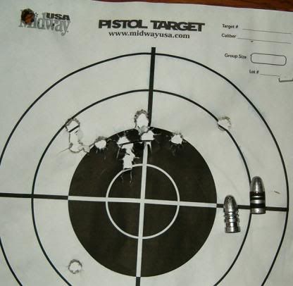

Charles I'm shooting the rcbs 400csa bullet (also use it in the wifes 4065 bpcr) That bullet drops from the mold at just over .412, I lube thru the .413 size die.crs wrote:Don;
Could you share with us your .405 loads for the 400 grain cast?
You know, bullet, powder, velocity, accuracy, etc.
Thank you.
Favorite powder charge is 25 grs of 5744. Bullet seated so the driving band just out of the case. Due to the bore rider design and good meplat it will work thru the magazine at that length
Have not chrono'ld that load but would expect it somewhere around 1600 fps.
Accuracy runs about 6 inches at 270 yds. Have not papered it at distance, but smacking the 800 yd kerosene barrel is not a problem
Also shoot a .400 359 gr paper patch bullet with the same charge of 5744 and accuracy is good, and with some tinkering could be brought to extreme.

Yes the 405's can be quite accurate. This group 100 yds 4 shots , 300 gr Northfork, 57 grs of rl 12 , cci large rifle primers.

Heres the lyman 412263 bullet cast from wheelweights ,28 grs of 5744, 50 yds sitting.
