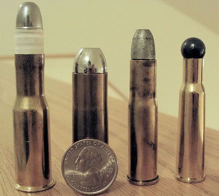

How many of you guys shoot rifles that require forming brass, or buying special made brass and dies in order to shoot?
Seems I spend a lot of time either loading up, or forming and loading oddball ammo around here.I'd guess over half the guns I own are in some caliber I could never buy off the shelf now.
Here's an example of a few I make. From left to right-
.40-60 Marlin, .45-70 (for comparison) .40-70 Sharps Straight, and .44-77 Sharps Bottleneck.

Very cool!!! 8) I love the obsolete stuff!

nice pic. :wink:

That is very, very cool!!! What cartridge did you use to make the .40-70 Sharps Straight?
Posts: 7140
The .40-70SS used to be a huge pain, but since Hornady reintroduced the .405 Win. it's a snap! I just run the .405 through my dies and load them up with a new 430 grain bullet, sized to .406"
I used to stretch .30-40 Krag brass and fireform it to fit the chamber. Tons of work!
