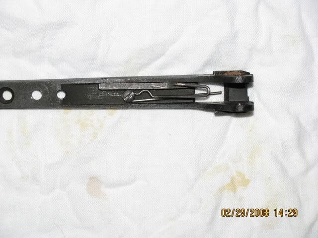

- Posts: 21332
Re: Winchester 1894
I don't believe I have a spare for that vintage, but echo trying Winchester Bob's. This part is simply a wire spring and can be made from good spring stock.
Good luck and welcome.
Edit: My bad, just looked, you want the 2nd version, which is a flat spring, very similar to the 3rd style, but without the portion for the coill mainspring. As the 3rd style is held in place by the same rollpin as the trigger block safety; I believe you can modify the third style by cutting off the holder for the coil mainspring. Parts are still available from USRA/Brownig/FN as p/n U346420870 TRIGGER STOP SPRING. At $1.50, I certainly try it.

Re: Winchester 1894
Griff: The spring in your picture is for the Pre-64, part #7394. The one after that is part #7394X and was a flat type. Then they went to part #7494X which is flat with a V on the end. Hope this may help.
***** Well I should have read the bottom of your response. Boy this old age is getting worse!!!!!!!!!
