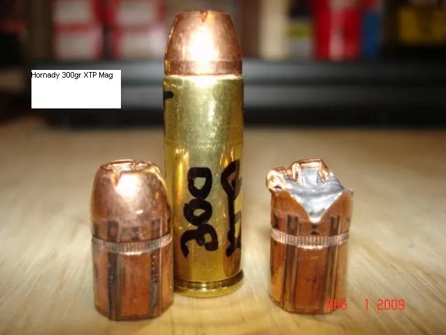

So Im liking the looks of the regular 300XTP. Saw a youtube test showing some minor expansion as low as 940fps, nice expansion at 1260fps impact and very expanded but still not fragmenting at 2000fps! Thats an impressive expansion envelope, will handle all my shooting from low power to high. I wont be trying to get 2000fps and Im not shooting cape buffalo with it anyway.

Well, if you say so, but I would advise the XTP Mag if it were me. I had very good results using Lil Gun and CCI BR4 primers. My chronograph results were much more consistent then Hornady factory 454 ammo. Velocity out of my 20" Puma was right about 2000 fps and my best friend's 16" barrel was only about 50 fps less than that, which was very interesting. Jim T. is quietly one of the most expert authorities on the 454 as he was there in its early years of testing and proto-typing. He filled in some missing pieces of information that I had not found in 20 years of forums and conversations on what is my favorite handgun cartridge (OK, the 460 Smith is also a favorite but just too darn big most of the time). -Tutt

Thanks Tutt, I saw this test on the 300 XTP-Mag,. Below was 1444fps impact, might even need another 100fps-150fps by the looks to really expand. Thats a water news print test btw if I recall, real game may provide better results. Will still kill fine no doubt, but yeah thats a tough bullet. Well I can try a few of each and see what the gun likes. run my own expansion tests through my setup,
