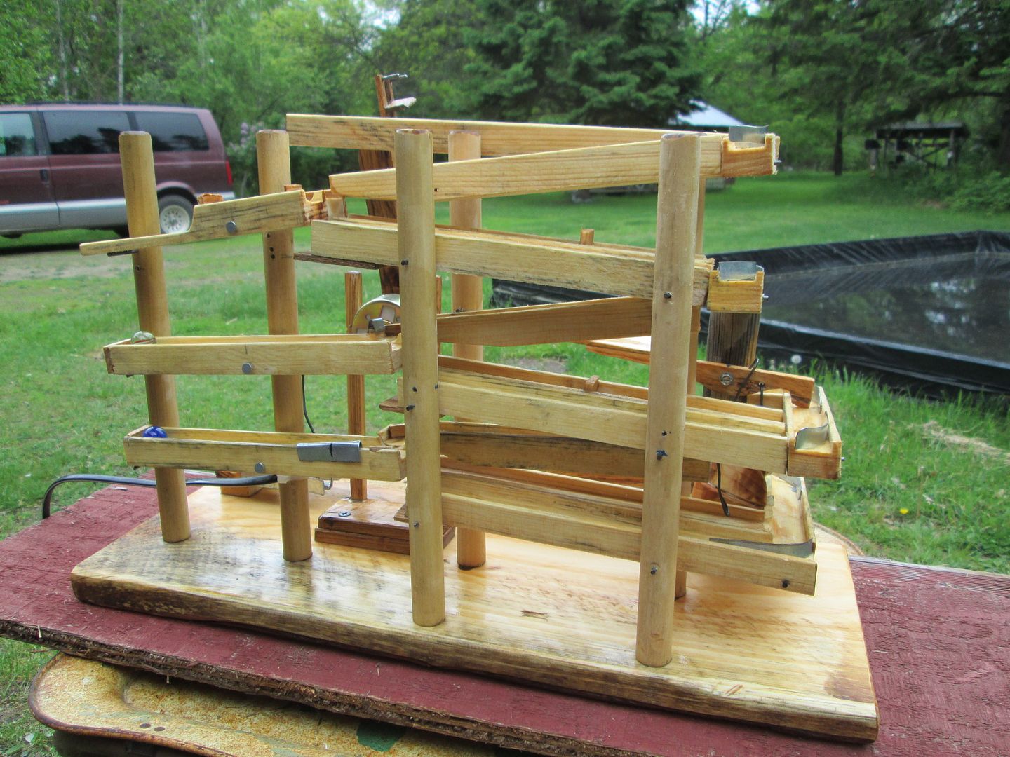

This is our latest creation, it`s a clock but I don`t have the numbers on the rails yet.
Do a youtube search on the subject to see them.
A video.

Thanks AJMD429, that`s a interesting clock too
I ordered some 1/2 inch steel bears for the clock that I hope work better, the marbles are light and hang up once in a while.

Grand machine Pitchy. I called my 7 year old in to watch the video. Almost every day for a month or so he asked me find Sandy Andy for him. He finally asked "How does it know when to dump?" I pointed out the stop at the bottom and told him that triggers the release. He just ran off and hasn't asked for it again.
Re: Rolling ball clock
Thanks Bill and MM.
MM the dump is triggered by a over balance , when the racks get full the last marble down it will tip it and dump that rack.
The thing at the bottom is where it picks up a new ball.
It`s a finicky thing, I think the steel balls will improve things, in fact I brought it in from the shop and the wood is drying out which changes things to the point of hang ups.

Update, I got the 5/8ths steel balls and they work perfect, I`ve run it a few days without a hitch but it does run a little fast which I don`t care about.
