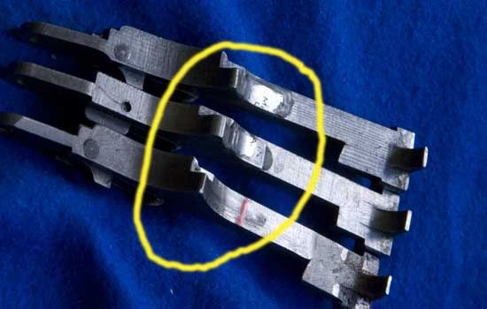

But old Earl is search-challenged enough that I couldn't find good enough info on this forum or on the Marlin-owners forum. I know the info is there, I just couldn't get to it with my limited computer abilities. But I did find that the problem is so common that it has a name: "Marlin Jam #1". And I found written reference indicating that one fellow fixed his by adding a little weld material in the appropriate place and grinding smooth, but didn't find pictures to go along with the instruction. I did mine with the old JB Weld and a little piece of steel, so finally gave in and took a Marlin apart. Fix area looks just fine after 15 (er...maybe 18 years). Took other Marlin apart, it also looks fine after a mere 15 years. Curiosity going, I took third Marlin down that has been trouble-free from the beginning. Here's how they look:
These, as you can see, are the bottom sides of 3 carriers: two upper ones with a little patch and the third that didn't need anything (areas inside yellow circle). Looking at the bottom one that always worked fine (1950 era 35 Rem.) I could see that the factory polishes the area . So I assume that they want this slick and smooth, but if they polish off .001 too much we have Marlin Jam #1. And if they get .002 too much they produce such consistent jamming that some of us lucky fellows get a bargain (like I did for my 1950 30/30 and the late 80's 35 Rem that yielded up the "patched" carriers for the photo).

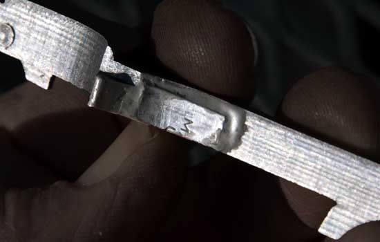

Anyway, here's a side view of the fixed area -- I used a little red sharpy marking to make it show up.

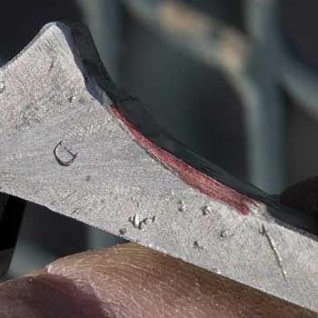

And here's a top view of the fix area
In my frustrated search effort I found nice photos where a fellow did a similar thing to a Marlin 1894, which has it's own Marlin 1894 Jam #1, I gather. He used a piece of saber-saw blade with the teeth ground off and cut to length. That sounds like a good idea: next time I think I'll use something like that, or hacksaw blade. you just need a thin piece of steel about 1/4" wide and maybe 3/4" long and saw blade should be thin, strong and smooth. I think for these particular fixes I had cut out a piece from the handle of a cheapo teaspoon.

That will definately work but I find it much easier to just heat and bend the front of the carrier up some. Just apply heat about where you welded.
There is supposed to be another fix but I haven't tried it. It that involves radius-ing the top inside of the entrance to the mag tube so the carrier can more easily push the round back into the tube. Sounds like it might work depending on just how far the jam round is getting in.
Bending the carrier is a fast fix and seems to do the trick.

Steve, is that bending the front of the carrier up as in the picture Earl shows, which would be actually down and towards the bottom of the receiver or up as towards the top of the receiver as the part is installed. I believe you mean up towards the top of the receiver if the carrier is installed. Thanks.

About how much of a bend, Steve? I'd guess a 32nd or so? As in "just a wee scosh"?

Yes, up toward the top. The idea is so that when the carrier bottoms out the front end is still high enough to catch the next round.
Yes, I try to get about .050" to .070". To measure I use three nails into a plywood board. One through the screw hole (tight if you got it), the middle one underneath about where you welded it then another one underneath out near the front. Set them up where all three touch then bend it so that the gap is out under the one up front. Does that make sense?
