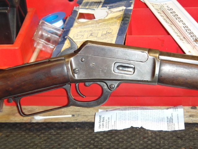

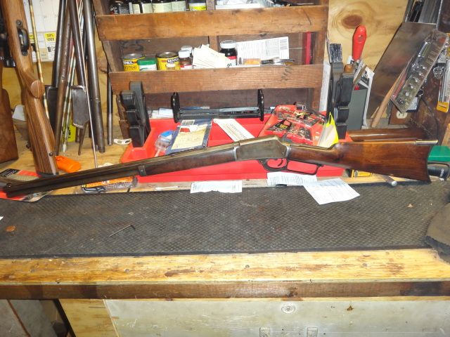

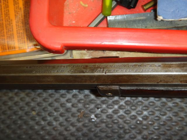

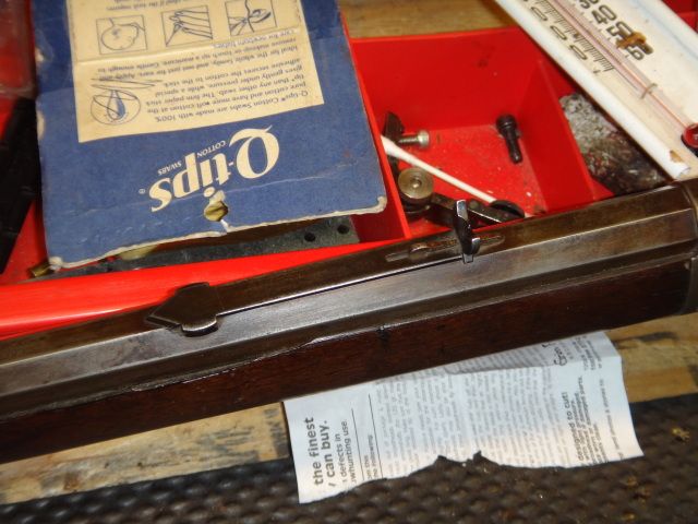

Got an 1889 Marlin 38/40 last week. All original cept for a screw & the sight elevator it looks like. The woods been oversanded though & about every screw is buggered. Bores not so good but the guy I got it from said it did good in cowboy action for him. We'll see, I'm not against getting it lined if I have too, I'm replacing the wood anyway. I need to change the fireing pin, get some brass, bullets & dies and see what happens. Couldnt beat the price. I'm a certified NRA instructor and I help a local guy out about once a month give the basic pistol course for carry permits. Last week he said "Merry Christmas in January Ken" and handed me the gun. I'm pretty tickled because I needed a 38/40 to complete the set. I have one in parts on my bench for a few years now but cant find time to get to it. This makes it alot easier, even better if the butstock I fitted to the parts gun fits on.

I love the 38WCF. No recoil and kills everything it hits. Good looking gun.

Nice rifle. I have relined one rifle and it shoots dot on! Decided against changin out the wood, kinda became attached to that old worn, beatup, but still capable of shooting well, look! Any way you go, it will be yours!

If the wood wasnt so oversanded I'd let it be. I like old wood but not when its been butchered. I'll stain the new pieces & they'll look right. If it shoots I wont line it, but its pretty bad, even the chamber is pitted.

Good looking rifle. The 89s just feel good in the hands.

What a neat piece of Marlin history! A distant frind of mine has an 1889 Marlin in 38-40. Unfortunately the bore is in real sad shape. With factory jacketed ammo the best it can do is 5"+ groups at 25 yards. I loaded some 38-40's using PSB (polyethylene shot buffer) over 4227 powder and a 180 gr cast bullet. He could not believe how well that ammunition shot....1" at 25 yards.
The PSB acts as a flexible gas check and allows the bullet to transverse the barrel without disturbance from any gas getting by. Something you might want to try if you do not get the accuracy you would be happy with.
